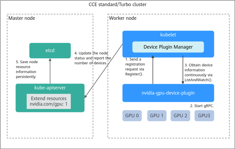

nvidia-gpu-device-plugin is one of the core components of CCE AI Suite (NVIDIA GPU). As a bridge between the container platform and GPU hardware, nvidia-gpu-device-plugin abstracts physical GPUs into resources that can be identified and scheduled by the container platform. This addresses the GPU allocation and usage problems in containerized environments.
- Sending a registration request: nvidia-gpu-device-plugin sends a registration request to kubelet as a client along with:
- Device name (nvidia.com/gpu): identifies the type of hardware resource managed by the add-on for kubelet to identify and schedule.
- Unix socket: enables local gRPC communication between the component and kubelet to ensure that kubelet can properly call the correct services.
- API version: specifies the version of the Device Plugin API protocol. It ensures that the communication protocols of both parties are compatible.
- Starting a service: After registration, nvidia-gpu-device-plugin starts a gRPC server to provide services for external systems. The gRPC server handles kubelet requests, including device list queries, health status reporting, and resource allocation. The listening address (Unix socket path) of the gRPC server and supported Device Plugin API version have been reported to kubelet during registration. This ensures that kubelet can properly establish connections and call the correct APIs based on the registration information.
- Health monitoring: After the gRPC server is started, kubelet establishes a persistent connection with nvidia-gpu-device-plugin through the ListAndWatch API to continuously listen to the device IDs and their health. If a device becomes unhealthy, nvidia-gpu-device-plugin reports the error to kubelet through the connection.
- Information reporting: kubelet integrates the device information into the node statuses and reports resource details such as the number of devices to Kubernetes API server. The scheduler (kube-scheduler or Volcano) uses these details to make scheduling decisions.
- Persistent storage: CCE stores the GPU device information (such as quantity and status) reported by nodes in etcd for cluster-level resource persistence. This ensures that GPU data can be kept after a cluster component is faulty or restarted, and provides consistent data sources for components such as the scheduler and controller, ensuring reliability of resource scheduling and management.

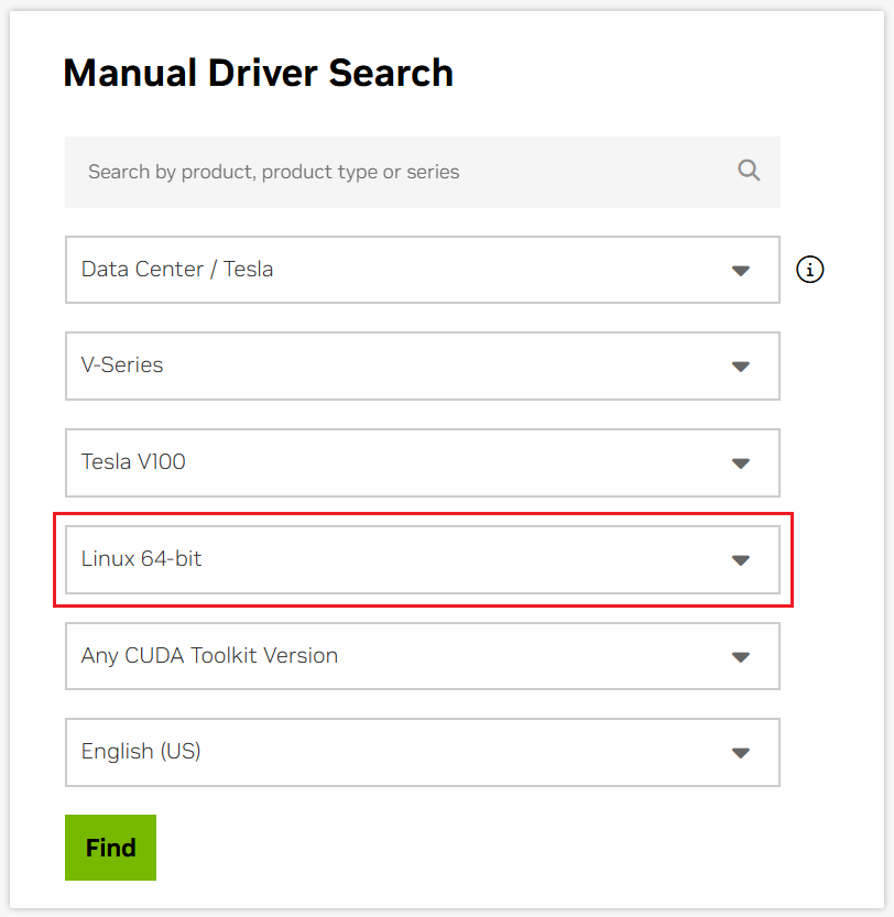

- Create a node. In the Specifications area, select the GPU node flavor. The GPU models are displayed in the lower part of the area.
- Go to the NVIDIA driver download page and search for the driver information. The OS must be Linux 64-bit. Figure 2 Selecting parameters

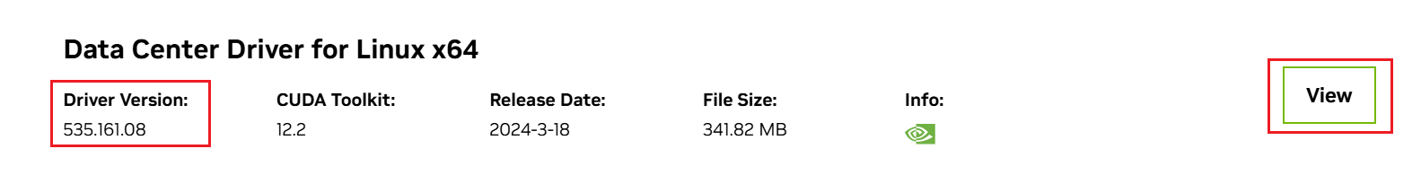

- After confirming the driver information, click Find. On the displayed page, find the driver to be downloaded and click View. Figure 3 Viewing the driver information

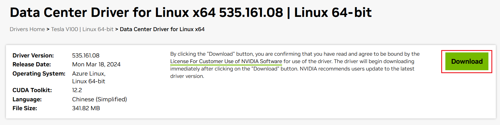

- Click Download and copy the download link. Figure 4 Obtaining the link
- Upload the driver to OBS and set the driver file to public read.
When the node is restarted, the driver will be downloaded and installed again. Ensure that the OBS bucket link of the driver is valid.
