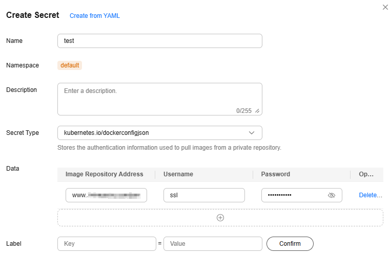

- In the navigation pane, choose ConfigMaps and Secrets. On the Secrets tab, click Create Secret.
- In the Create Secret dialog box, configure parameters based on Figure 1 and Table 1. For more details, see Creating a Secret.
Table 1 Parameters for creating a secret Parameter
Example Value
Description
Name
test
Name for the secret.
Enter up to 253 characters, starting and ending with a lowercase letter or digit. Only lowercase letters, digits, hyphens (-), and periods (.) are allowed.
Secret Type
kubernetes.io/dockerconfigjson
Type of the secret.
The value is fixed at kubernetes.io/dockerconfigjson, indicating that the secret is used for authentication when third-party images are pulled.
Data
Image Repository Address: www.example.com
Username: ssl
Password: xxx
- Image Repository Address: Enter the address of the third-party image repository.
- Username: Enter the username for accessing the third-party image repository.
- Password: Enter the password for accessing the third-party image repository.
