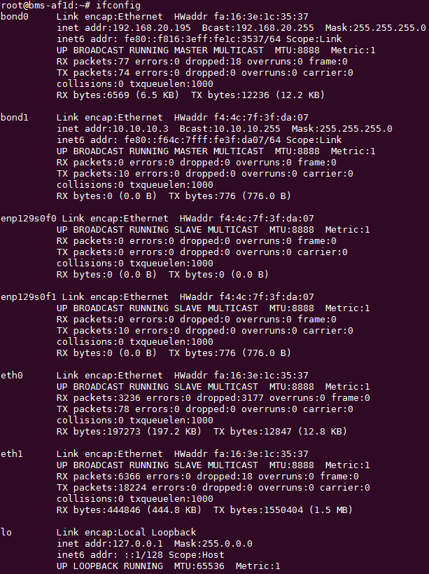

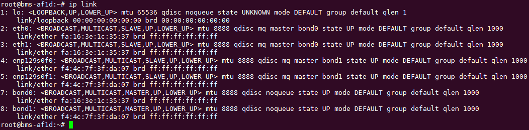

  9. Run the following commands to check the NIC device status and whether the bond1 configuration file takes effect:
    ip link
    ifconfig
