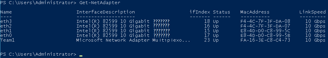

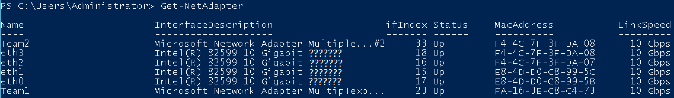

  2. On the Windows PowerShell CLI of the BMS, run the following command to check the NIC information:
    Get-NetAdapter
    Information similar to the following is displayed.
    Among the devices, eth0 and eth1 bear the VPC, and eth2 and eth3 bear the user-defined VLAN. The following steps use eth2 and eth3 to configure a user-defined VLAN.

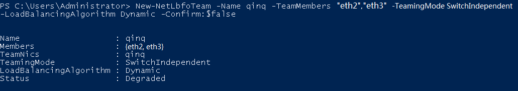

    1. Run the following command to create a port group for the user-defined VLAN:
      New-NetLbfoTeam -Name qinq -TeamMembers "eth2","eth3" -TeamingMode SwitchIndependent -LoadBalancingAlgorithm Dynamic -Confirm:$false
      In the command, qinq is the name of the port group planned for the user-defined VLAN, and eth2 and eth3 are the network devices that bear the user-defined VLAN obtained in step 2.

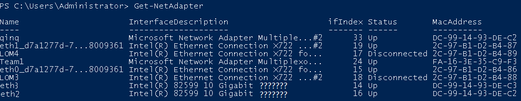

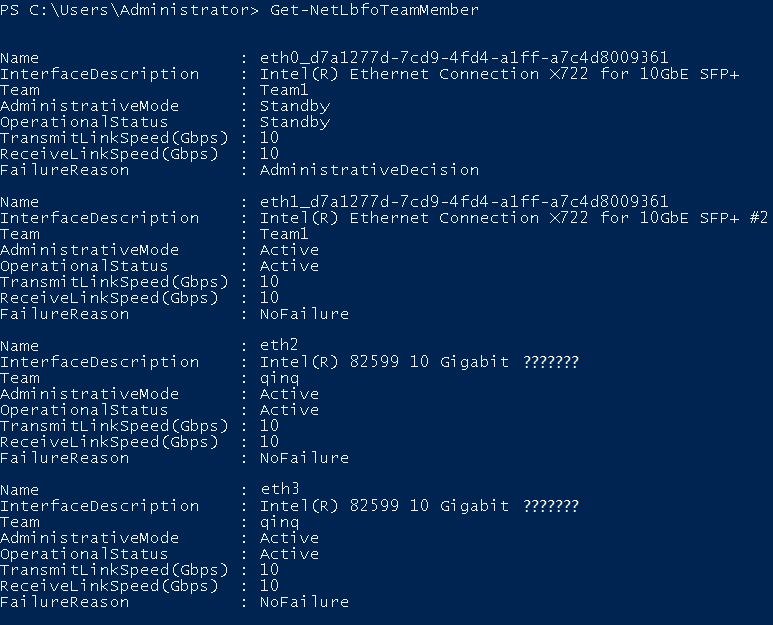

    2. Run the following command to query the network adapters:
      Get-NetLbfoTeamMember
      Get-NetAdapter

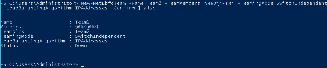

      New-NetLbfoTeam -Name Team2 -TeamMembers "eth2","eth3" -TeamingMode SwitchIndependent -LoadBalancingAlgorithm IPAddresses -Confirm:$false
      In the command, Team2 is the name of the port group planned for the user-defined VLAN, and eth2 and eth3 are the network devices that bear the user-defined VLAN obtained in step 2.

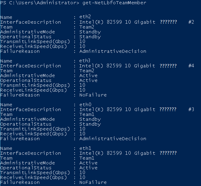

    2. Run the following command to set a network port of port group Team2 created in 3.a to the standby port:
      Set-NetLbfoTeamMember -Name "eth2" -AdministrativeMode Standby -Confirm:$false
      The port group configured for the user-defined VLAN supports only the active/standby mode. eth2 is one of the ports of the port group. You can determine which port is configured as the standby port based on your planning.
      get-NetLbfoTeamMember
      Get-NetAdapter

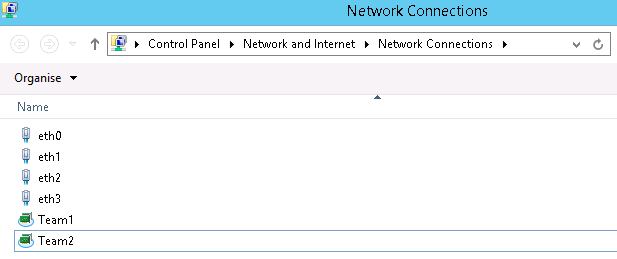

  4. Run the following command to enter the Network Connections page:
    ncpa.cpl
    Then enter the following page.

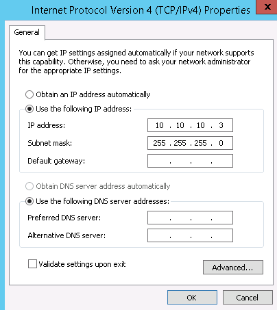

    3. On the Networking tab page, double-click Internet Protocol Version 4 (TCP/IPv4) to switch to the Internet Protocol Version 4 (TCP/IPv4) Properties page.
    4. Select Use the following IP address, configure the IP address and subnet mask, and click OK.
      If the IP address planned for the user-defined VLAN does not conflict with the VPC network segment, you can plan the IP address as needed, only to ensure that BMSs communicating through the user-defined VLAN are in the same network segment as the user-defined VLAN.

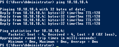

  7. After all BMSs are configured, ping the IP addresses of other BMSs from each BMS.

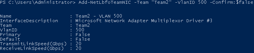

  8. If you want to configure VLAN sub-interfaces to isolate network planes, perform the following operations:
    Run the following command to create a VLAN sub-interface based on the existing Team2:
    Add-NetLbfoTeamNIC -Team "Team2" -VlanID XXX -Confirm:$false
    In the preceding command, Team2 indicates the bond name, and XXX indicates the VLAN ID.
    After the VLAN sub-interface is created, configure the IP address and subnet mask of network port Team2-VLAN 500 by referring to 4 and 5.
