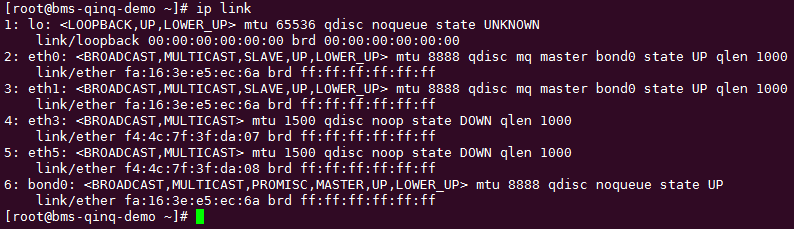

  2. On the BMS CLI, run the following command to check the NIC information:
    ip link
    Information similar to the following is displayed.
    Among the devices, eth0 and eth1 bear the VPC, and eth3 and eth5 bear the user-defined VLAN.

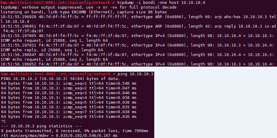

  10. Perform the preceding operations to configure other BMSs.
  11. After all BMSs are configured, ping the IP addresses of other BMSs from each BMS.
