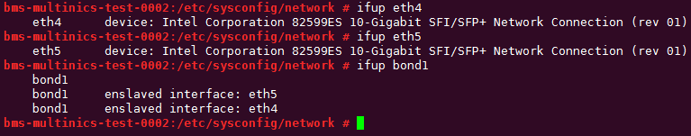

  9. Run the following commands to restart the network:
    ifup eth4
    ifup eth5
    ifup bond1
    eth4 and eth5 are the network ports bear the user-defined VLAN and bond1 is the port group of the user-defined VLAN.

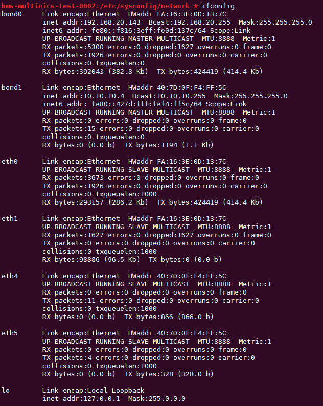

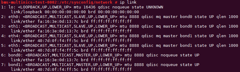

  10. Run the following commands to check the NIC device status and whether the bond1 configuration file takes effect:
    ip link
    ifconfig
