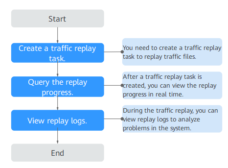

Process
Figure 1 Workload replay process
This section describes how to create a workload replay task from RDS for MySQL to RDS for MySQL. To configure other storage engines, you can refer to the following procedures.
