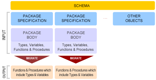

Packages are schema objects that group logically related PL/SQL types, variables, functions and procedures. In Oracle, each package consists of two parts: package specification and package body. The package specification may contain variables and REF CURSOR in variables. The package REF CURSORs are identified and migrated in the referred places. The functions and procedures in the package body are migrated into individual functions and procedures. The types and variables in the package body are migrated to each of the functions and procedures.
If the schema names of the package specification and package body do not match, then the tool will log a schema name mismatch error to the DSCError.log file.
