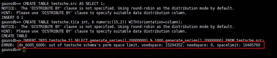

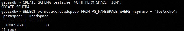

  • WITH PERM SPACE 'space_limit'
    Indicates the storage upper limit of the permanent table in the specified schema. If space_limit is not specified, the space is not limited.
    Value range: A string consists of an integer and unit. The unit can be K/M/G/T/P currently. The unit of parsed value is K and cannot exceed the range that can be expressed in 64 bits, which is 1 KB to 9007199254740991 KB.
