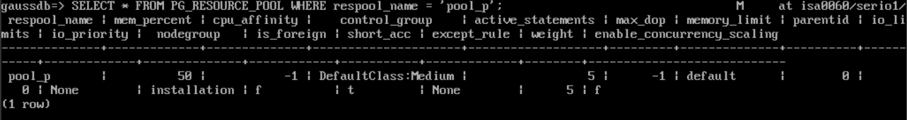

Query the configuration parameters of the resource pool in the PG_RESOURCE_POOL system catalog.
SELECT * FROM PG_RESOURCE_POOL WHERE respool_name = 'pool_p';

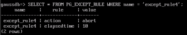

  7. Check exception rule definitions in the PG_EXCEPT_RULE system catalog.
    SELECT * FROM PG_EXCEPT_RULE WHERE name = 'except_rule4';
