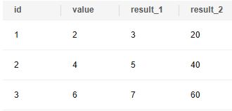

The data in table test_data is used. The value column in the table is used as the input parameter of the compute function. The calculation result is as follows:
1 2 3 4 5 6 | DROP TABLE IF EXISTS test_data; CREATE TABLE test_data (id serial, value int); INSERT INTO test_data (value) VALUES (2), (4), (6); SELECT id, value, (compute(value)).* FROM test_data ORDER BY 1; |

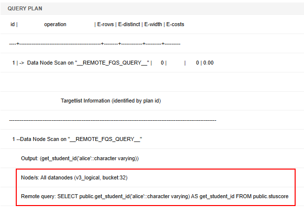

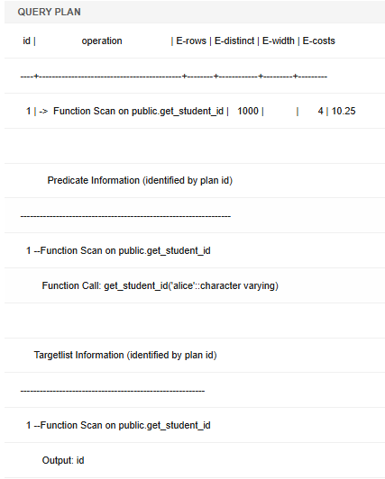

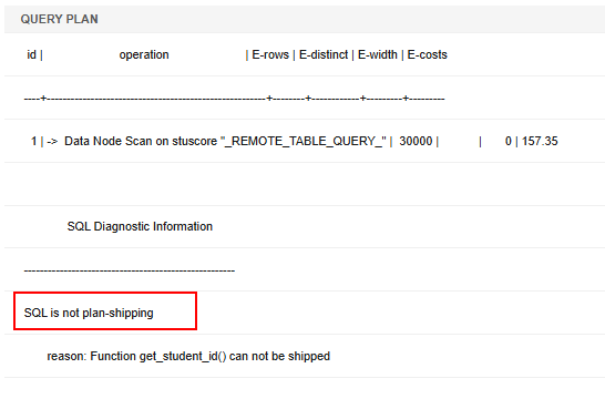

Function Pushdown Logic and Example
Pushdown logic for functions has two main aspects:
- The system checks if the entire function can be pushed down based on its SHIPPABLE attribute.
- If the full function is not pushed down, the optimizer automatically determines which individual SQL statements within the function can be executed separately.
