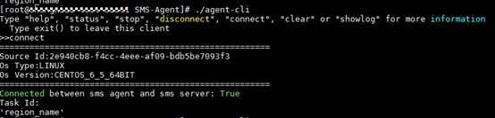

- Switch to the SMS-Agent directory on the source server, run ./agent-cli, enter connect, and press Enter to connect the source server to SMS.
- Run clear in the CLI.
After about a minute, the temporary disk on the target server will be detached and deleted, and the original system disk will be attached back.

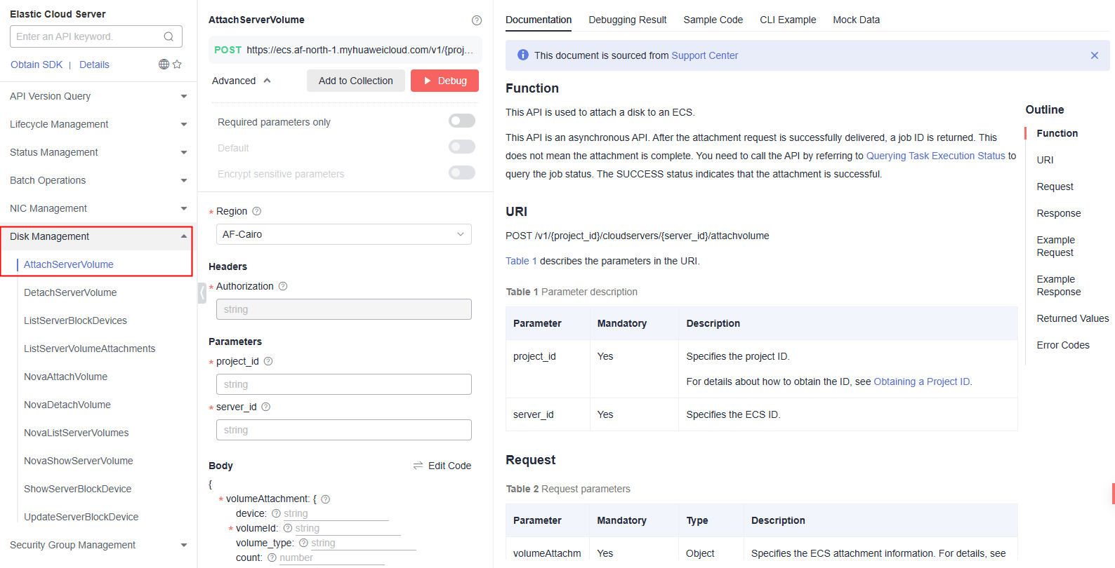

- Log in to the ECS console, locate the target server, and detach the temporary system disk. For details, see Detaching an EVS Disk from a Running ECS.
- Log in to the API Explorer.
- Set the following parameters:
- Region: Select the target region.
- Project_id: indicates the project ID, which is automatically filled after login. You can leave it blank.
- server_id: indicates the ID of the server to which the system disk is to be attached.
- device: indicates the disk mount point.
- For Xen ECSs, device is mandatory. Set device to /dev/sda.
- For KVM ECSs, set device to dev/vda.
- volumeId: indicates the ID of the disk to be attached. The value is in UUID format.
Figure 1 Attaching disks
