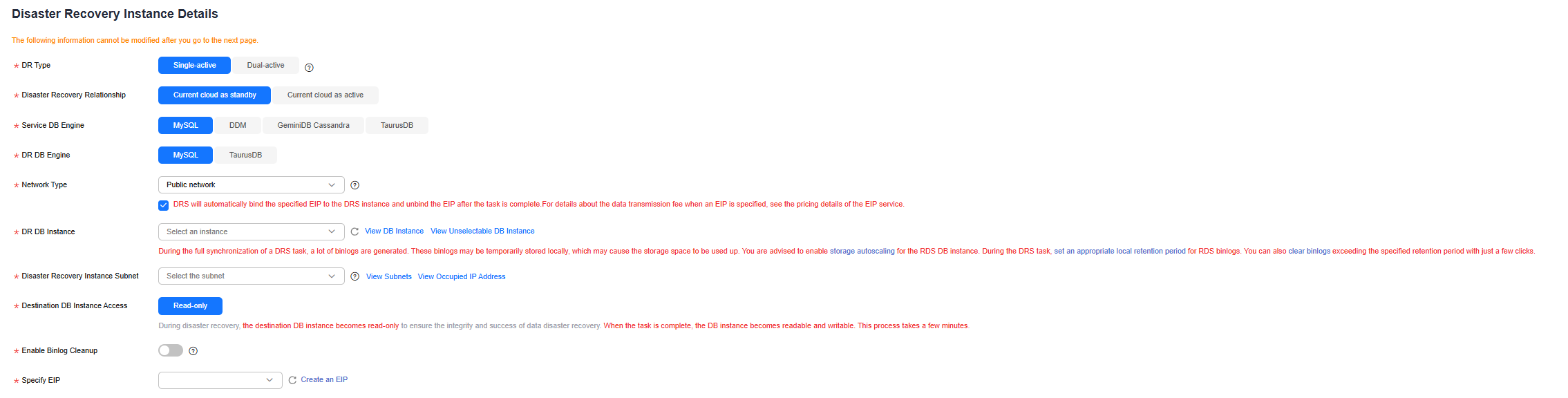

- DR instance information
Figure 1 DR instance information
Table 5 DR instance settings Parameter
Description
DR Type
Select Single-active.
The DR type can be single-active or dual-active. If Dual-active is selected, two subtasks are created by default, a forward DR task and a backward DR task.
NOTE:Only whitelisted users can use dual-active DR. To use this function, submit a service ticket. In the upper right corner of the management console, choose Service Tickets > Create Service Ticket to submit a service ticket.
Disaster Recovery Relationship
Select Current cloud as standby. This parameter is available only when you select Single-active.
By default, Current cloud as standby is selected. You can also select Current cloud as active.
- Current cloud as standby: The DR database is on the current cloud.
- Current cloud as active: The service database is on the current cloud.
Service DB Engine
Select MySQL.
DR DB Engine
Select MySQL.
Network Type
The public network is used as an example.
Available options: VPN or Direct Connect and Public network. By default, the value is Public network.
DR DB Instance
RDS DB instance you have created as the destination database of the DR task.
Disaster Recovery Instance Subnet
Select the subnet where the disaster recovery instance is located. You can also click View Subnets to go to the network console to view the subnet where the instance resides.
By default, the DRS instance and the DR DB instance are in the same subnet. You need to select the subnet where the DRS instance resides and ensure that there are available IP addresses. To ensure that the disaster recovery instance is successfully created, only subnets with DHCP enabled are displayed.
Destination DB Instance Access
Select Read-only. This parameter is available when you select Single-active for DR Type and Current cloud as standby for Disaster Recovery Relationship.
- During disaster recovery, the entire DR database instance becomes read-only. To change the DR database to Read/Write, you can change the DR database (or destination database) to a service database by clicking Promote Current Cloud on the Disaster Recovery Monitoring tab.
- If a DR task fails, the DR database does not automatically change to the read/write state.
- If a DR task is paused, you can disable read-only for the DR database. For details, see Disabling or Enabling Read-Only.
- After read-only is disabled and the DR task is resumed, the DR database automatically changes to read-only. The read-only settings of the DR DB instance are also affected by the access settings of the DB instance itself. Therefore, you are advised not to set the access settings of the DB instance on the RDS console.
- After the DR task is complete, the DR database changes to Read/Write.
- When the external database functions as the DR database, the user with the superuser permission can set the database to read-only.
- If a DRS instance node is rebuilt due to a fault, to ensure data consistency during the DRS task restoration, the current cloud standby database is set to read-only before the task is restored. After the task is restored, the synchronization relationship recovers.
Enable Binlog Cleanup
This parameter is available when you set Disaster Recovery Relationship to Current cloud as standby. It indicates whether to enable the function of quickly clearing binlogs of the destination database. After this function is enabled, binlog clearing is enabled for the DR database during the full synchronization and disabled during the incremental synchronization.
Specify EIP
This parameter is available when you select Public network for Network Type. Select an EIP to be bound to the DRS instance. DRS will automatically bind the specified EIP to the DRS instance and unbind the EIP after the task is complete. The number of specified EIPs must be the consistent with that of DB instances.

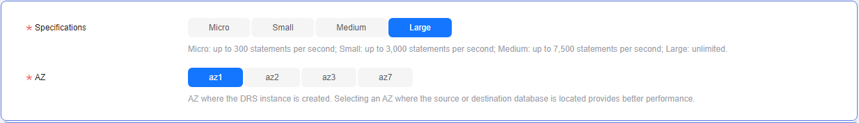

- Specifications
Figure 2 Specifications
Table 6 Specifications Parameter
Description
Specifications
DRS instance specifications. Different specifications have different performance upper limits. For details, see Real-Time DR.
NOTE:DRS allows you to upgrade specifications only for real-time DR tasks from MySQL to MySQL, from MySQL to TaurusDB, and from TaurusDB to TaurusDB. Task specifications cannot be downgraded. For details, see Changing Specifications.
AZ
Select the AZ where you want to create the DRS task. Selecting the one housing the source or destination database can provide better performance.

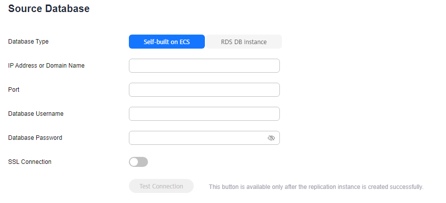

- On the Configure Source and Destination Databases page, wait until the DR instance is created. Then, specify source and destination database information and click Test Connection for both the source and destination databases to check whether they have been connected to the DR instance. After the connection tests are successful, select the check box before the agreement and click Next.
- Select Current cloud as standby for Disaster Recovery Relationship in 2.
Figure 3 Service database information
Table 8 Service database settings Parameter
Description
Database Type
By default, Self-built on ECS is selected.
The source database can be a Self-built on ECS or an RDS DB instance. After selecting RDS DB instance, select the region where the source database resides and the region cannot be the same as the region where the destination database resides. The region where the destination database is located is the region where you log in to the management console. To use the RDS DB instance option, submit a service ticket.
IP Address or Domain Name
The IP address or domain name of the service database.
Port
The port of the service database. Range: 1 – 65535
Database Username
The username for accessing the service database.
Database Password
The password for the service database username. You can change the password if necessary. To change the password, perform the following operation after the task is created:
If the task is in the Starting, Initializing, Disaster recovery in progress, or Disaster recovery failed status, in the Connection Information area on the Basic Information tab, click Modify Connection Details. In the displayed dialog box, change the password.
SSL Connection
SSL encrypts the connections between the source and destination databases. If SSL is enabled, upload the SSL CA root certificate.
NOTE:- The maximum size of a single certificate file that can be uploaded is 500 KB.
- If SSL is disabled, your data may be at risk.

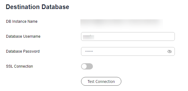

Figure 4 DR database information
Table 9 DR database settings Parameter
Description
DB Instance Name
The DB instance you selected when creating the DR task and cannot be changed.
Database Username
The username for accessing the DR database.
Database Password
The password for the database username. The password can be changed after a task is created.
If the task is in the Starting, Initializing, Disaster recovery in progress, or Disaster recovery failed status, in the DR Information area on the Basic Information tab, click Modify Connection Details. In the displayed dialog box, change the password.
The database username and password are encrypted and stored in DRS, and will be cleared after the task is deleted.
SSL Connection
If SSL connection is required, enable SSL on the DR database, ensure that related parameters have been correctly configured, and upload an SSL certificate.

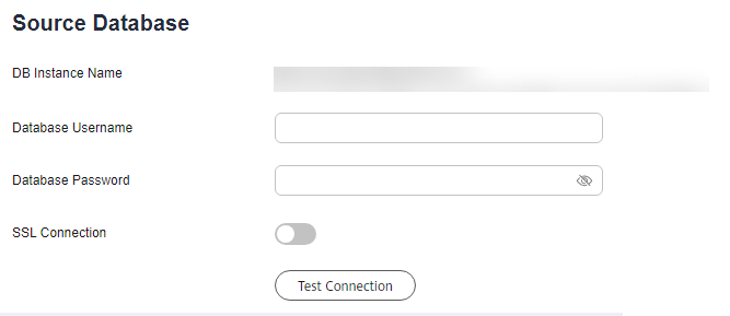

- Select Current cloud as active for Disaster Recovery Relationship in 2.
Figure 5 Service database information
Table 10 Service database settings Parameter
Description
DB Instance Name
The RDS instance selected when you created the DR task. This parameter cannot be changed.
Database Username
Database Password
The password for the database username. You can change the password if necessary. To change the password, perform the following operation after the task is created:
The database username and password are encrypted and stored in the system and will be cleared after the task is deleted.
SSL Connection
If SSL connection is required, enable SSL on the service database, ensure that related parameters have been correctly configured, and upload an SSL certificate.

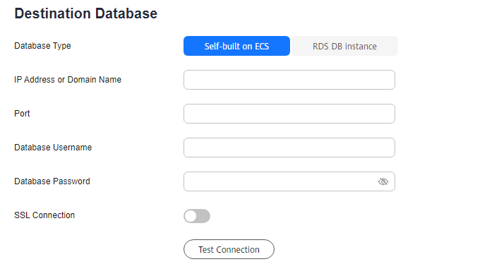

Figure 6 DR database information
Table 11 DR database settings Parameter
Description
Database Type
The destination database can be a Self-built on ECS or an RDS DB instance. If you select RDS DB instance, you need to select the region where the destination database is located. To use the RDS DB instance option, submit a service ticket.
The IP address or domain name of the DR database.
Port
The port of the DR database. Range: 1 – 65535
Region
The region where the RDS DB instance is located. This parameter is available only when the destination database is an RDS DB instance.
DB Instance Name
DR instance name. This parameter is available only when the destination database is an RDS DB instance.
NOTE:When the DB instance is used as the DR database, it is set to read-only. After the task is complete, the DB instance can be readable and writable.
Database Username
Username for logging in to the DR database.
Database Password
Password for the database username.
SSL Connection
The IP address, domain name, username, and password of the DR database are encrypted and stored in DRS and will be cleared after the task is deleted.
