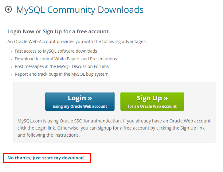

  3. Download the mysql client installation package for Linux locally. A mysql client running a version later than that of the DB instance is recommended.
    Find the link to the required version on the download page. The mysql-community-client-8.0.21-1.el6.x86_64 is used as an example.
    Figure 1 Downloading a mysql client

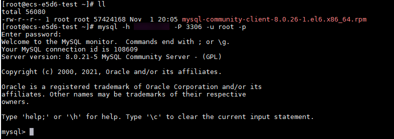

Step 4: Connect to the DB Instance Using the mysql Client
  1. Run the following command on the ECS to connect to the DB instance:
    mysql -h<host>-P <port> -u<userName> -p
    Example:
    mysql -h 192.*.*.* -P 3306 -u root -p
    Table 8 Parameter description
    Parameter
    Description
    <host>
    Private IP address obtained in 4.
    <port>
    Database port obtained in 4. The default value is 3306.
    <userName>
    Administrator account root.
  2. Enter the password of the database account if the following information is displayed:
    Enter password:
    Figure 2 Connection succeeded

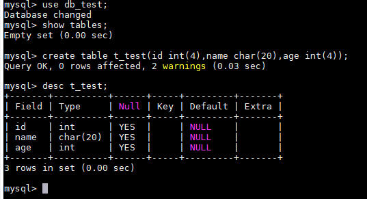

  4. Create a table, for example, t_test.
    create table t_test(id int(4), name char(20), age int(4));
    Figure 4 Creating a table

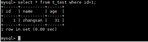

  8. Query the updated table data.
    select * from t_test where id=1;
    Figure 8 Querying the updated data

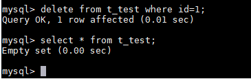

  9. Delete the data record whose id is 1 from the table.
    delete from t_test where id=1;
    Figure 9 Deleting table data
