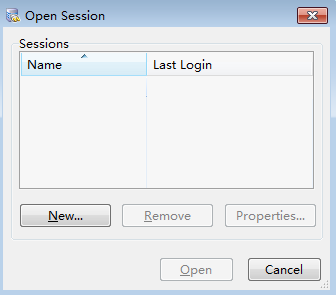

  1. Start MySQL-Front.
  2. In the displayed dialog box, click New.
    Figure 1 Connection management

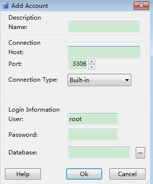

  3. Enter the information of the DB instance to be connected and click Ok.
    Figure 2 Adding an account
    Table 8 Parameter description
    Parameter
    Description
    Name
    Database connection task name. If you do not specify this parameter, it will be the same as that configured for Host by default.
    Host
    Private IP address.
    Port
    Database port. The default value is 3306.
    User
    Account name of the DB instance. The default value is root.
    Password
    Password of the account for accessing the DB instance.

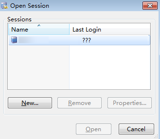

  4. In the displayed window, select the connection that you have created in 3 and click Open. If the connection information is correct, the DB instance is successfully connected.
    Figure 3 Opening a session
