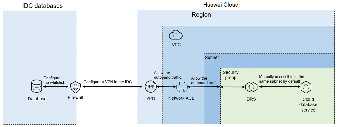

Figure 1 shows how to use DRS to migrate data from on-premises databases to Huawei Cloud databases using a VPN.
Figure 1 Network diagram

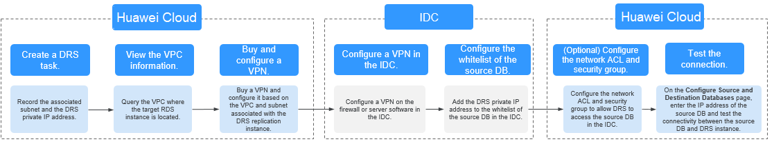

To access a database in the local data center using a VPN, purchase the VPN service on Huawei Cloud and configure the VPN to connect to the VPC that contains the DRS instance. In addition, you need to configure the VPN device on the firewall or host in the local data center. Figure 2 shows the operation process.
Figure 2 Flowchart

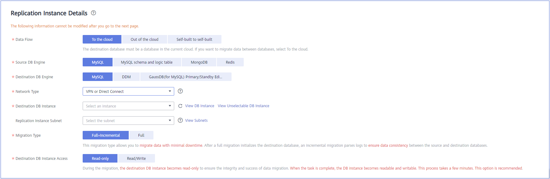

  1. Create a DRS instance and obtain the subnet and private IP address of the DRS instance.
    By default, the DRS instance is in the same subnet as the destination database.
    Figure 3 Replication instance information

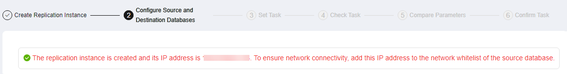

    After the DRS replication instance is created, the private IP address of the DRS replication instance is displayed.
    Figure 4 Private IP address of the DRS instance

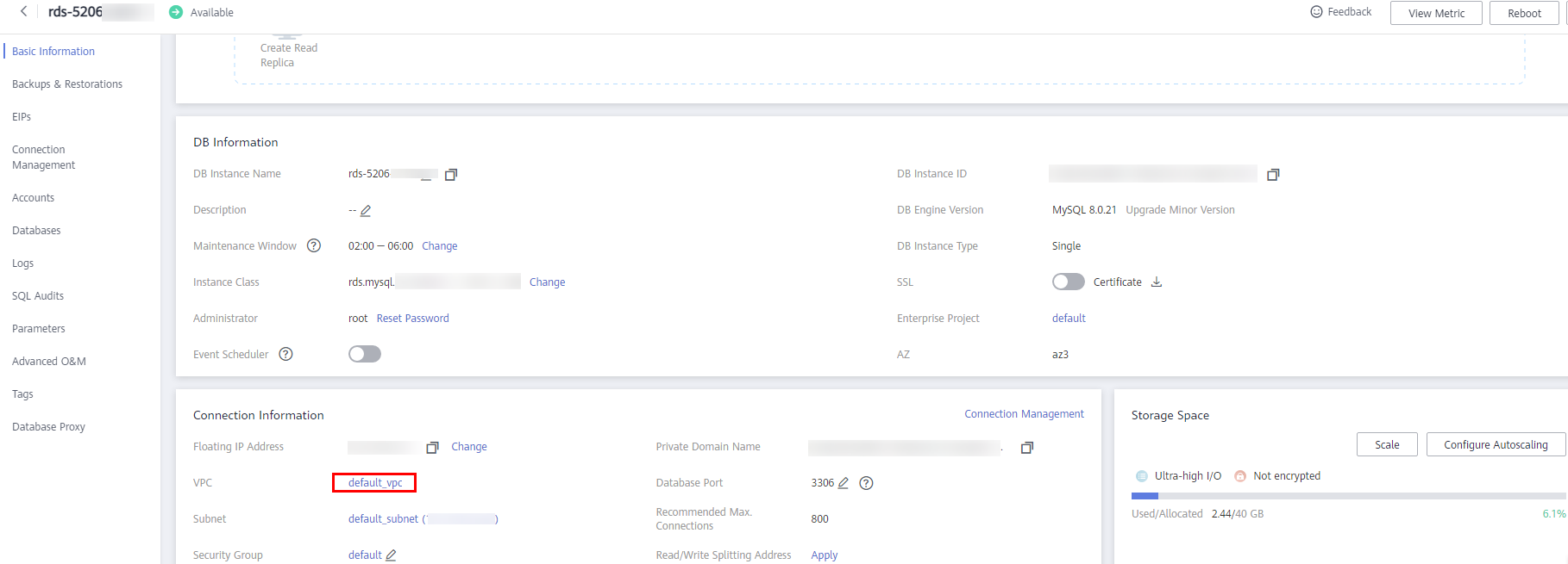

  2. Query the name of the VPC to which the DRS instance belongs.
    By default, the DRS replication instance and the destination RDS instance are created in the same VPC. You can log in to the destination RDS instance to view information about the VPC where the replication instance is located.
    Figure 5 Destination database information
