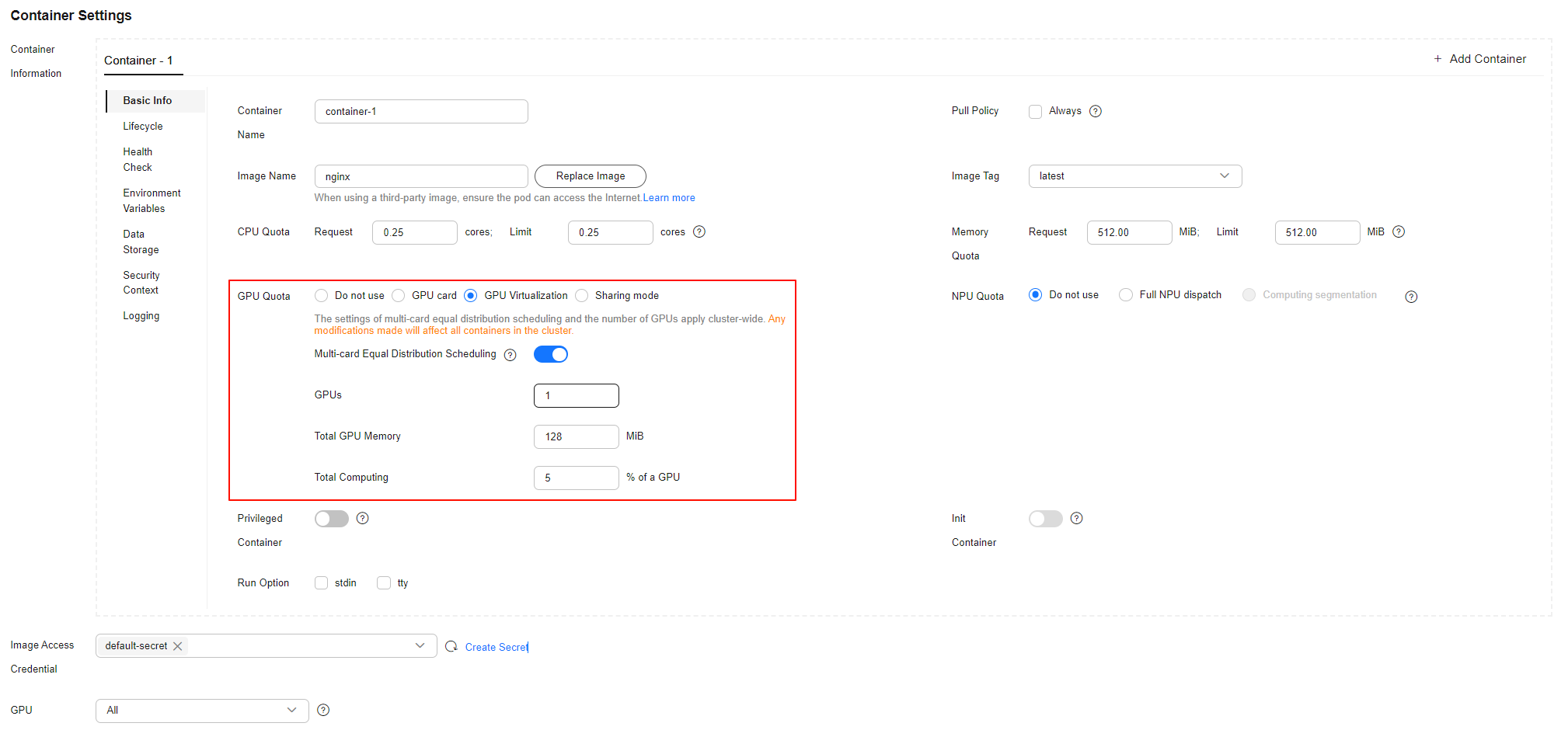

  1. Log in to the CCE console and click the cluster name to access the cluster console. In the navigation pane, choose Workloads. In the upper right corner of the displayed page, click Create Workload.
  2. In the Container Settings area, choose Basic Info in the navigation pane and then set GPU Quota to GPU Virtualization. Enable Multi-card Equal Distribution Scheduling. For details about parameter settings, see Table 1.
    The settings of multi-card equal distribution scheduling and the number of GPUs apply cluster-wide. Any modifications made will affect all containers in the cluster.
    Figure 1 Multi-card Equal Distribution Scheduling
    Table 1 Parameters for multi-card equal distribution scheduling
    Parameter
    Example Value
    Description
    GPUs
    (Mandatory) The number of GPUs for multi-card equal distribution scheduling.
    Total GPU Memory
    128
    (Mandatory) The requested GPU memory size in MiB. It must be a positive integer and a multiple of 128. If the specified value exceeds the total GPU memory, scheduling will fail.
    Total Computing
    5
    (Optional) The requested GPU compute as a percentage. The value must be a multiple of 5 and is determined by the number of GPUs.
    • If this parameter is left blank, the container uses GPU memory isolation.
    • If set, the container uses isolation of both compute and memory resources.
  3. Configure other parameters by referring to Creating a Workload. Then, click Create Workload in the lower right corner. When the workload changes to the Running state, it has been created.
