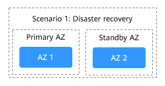

- Scenario 1: If DR is required, deploy the primary and standby instances in different AZs.
Example: Select AZ1 for Primary AZ and AZ2 for Standby AZ.
Figure 1 AZ selection for DR capability requirements

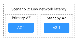

- Scenario 2: For lower network latency, deploy the primary and standby instances in the same AZ. Unlike DR scenarios, this configuration reduces latency significantly.
Example: Select AZ1 for both Primary AZ and Standby AZ.
Figure 2 AZ selection for low network latency
