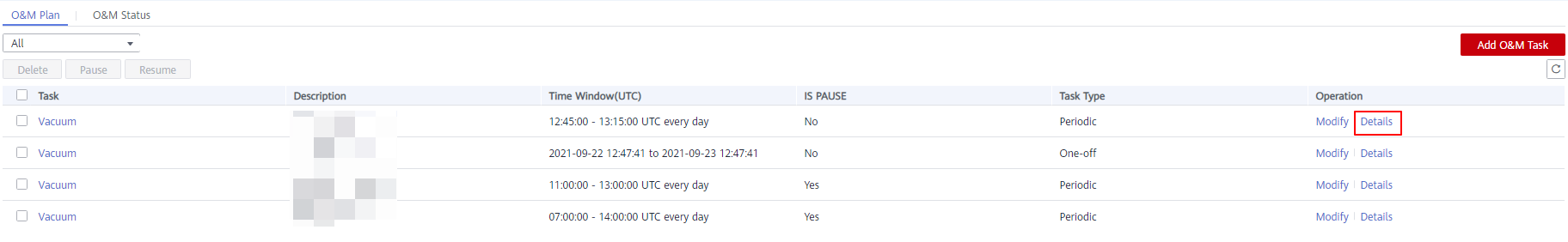

    Viewing plan details
    Locate a plan, click Details in the Operation column, and check the information on the displayed page.
