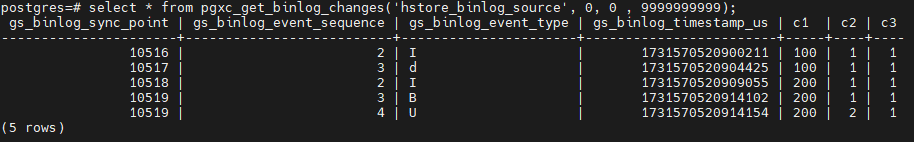

Querying Binlogs
You can use the system functions provided by GaussDB(DWS) to query the binlog information of the target table on a specified DN and check whether the binlog is consumed by downstream processes.
         1 2 3 4 5 6 7 8 9 10  |
         -- Simulate Flink to call a system function to obtain the synchronization point. The parameters indicate the table name, slot name, whether the point is a checkpoint, and target DN (0 indicates all DNs). select * from pg_catalog.pgxc_get_binlog_sync_point('hstore_binlog_source', 'slot1', false, 0); select * from pg_catalog.pgxc_get_binlog_sync_point('hstore_binlog_source', 'slot1', true, 0); -- Incremental binlogs are generated after additions, deletions, and modifications. INSERT INTO hstore_binlog_source VALUES(100, 1, 1); delete hstore_binlog_source where c1 = 100; INSERT INTO hstore_binlog_source VALUES(200, 1, 1); update hstore_binlog_source set c2 =2 where c1 = 200; -- Simulate Flink to call a system function to query the binlog of a specified CSN range. The parameters indicate the table name, target DN (0 indicates all DNs), start CSN point, and end CSN point. select * from pgxc_get_binlog_changes('hstore_binlog_source', 0, 0 , 9999999999);  |
Two INSERT operations generate two records with gs_binlog_event_type as I. The DELETE operation generates a record whose type is d. The UPDATE operation generates a B record for BeforeUpdate and a U record for AfterUpdate, indicating the values before and after the update.

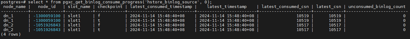

Obtain the consumption progress of the table for which the binlog timestamp function is enabled.
The returned fields indicate the timestamp of the latest consumed binlog, the latest timestamp on the binlog, the CSN point of the latest consumed binlog, the latest CSN point on the binlog, and the number of unconsumed binlog records.
        1 2 3 4 5  |
