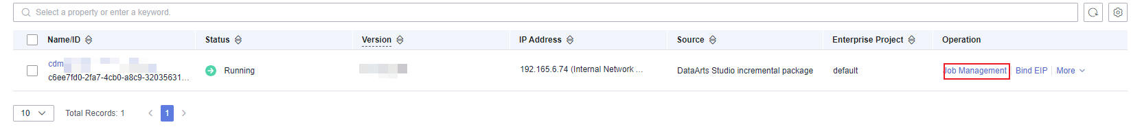

  2. On the Cluster Management page, click Job Management in the Operation column.
    Figure 1 Cluster Management

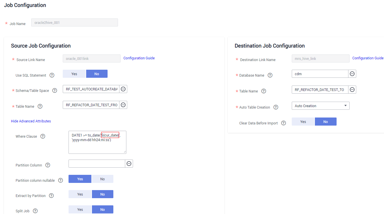

  5. Configure parameters for the source Oracle link and destination MRS Hive link, and configure the parameter to transfer in ${varName} format (${cur_date} in this example).
    Figure 2 Creating a job
    NOTE:
    The Retry upon Failure parameter is unavailable in the CDM migration job. You can configure this parameter on the CDM node in DataArts Factory.

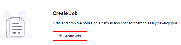

  3. On the Develop Job page, click Create Job.
    Figure 4 Create Job

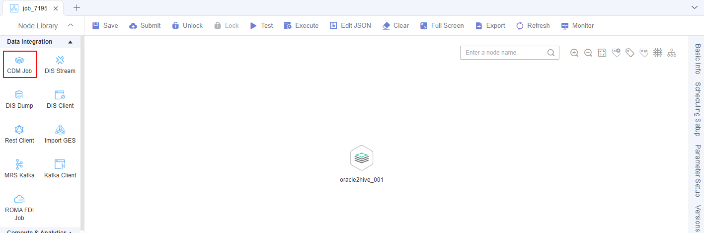

  5. Add a CDM Job node in the data development job and associate the node with the created CDM job.
    Figure 5 Associating the CDM Job node with the created CDM job

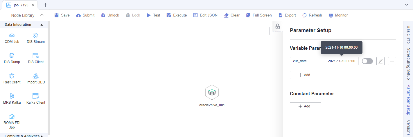

  6. Configure the parameter to be transferred to the CDM job.
    Figure 6 Configuring the parameter to be transferred
    NOTE:
    When the job is scheduled and executed, the value of the configured parameter will be transferred to the CDM job. The value of the parameter cur_date can be set to a fixed value (for example, 2021-11-10 00:00:00) or an EL expression (for example, #{DateUtil.format(DateUtil.addDays(Job.planTime,-1),"yyyy-MM-dd")} which means the day before the scheduled job execution date. For more EL expressions, see EL expressions.

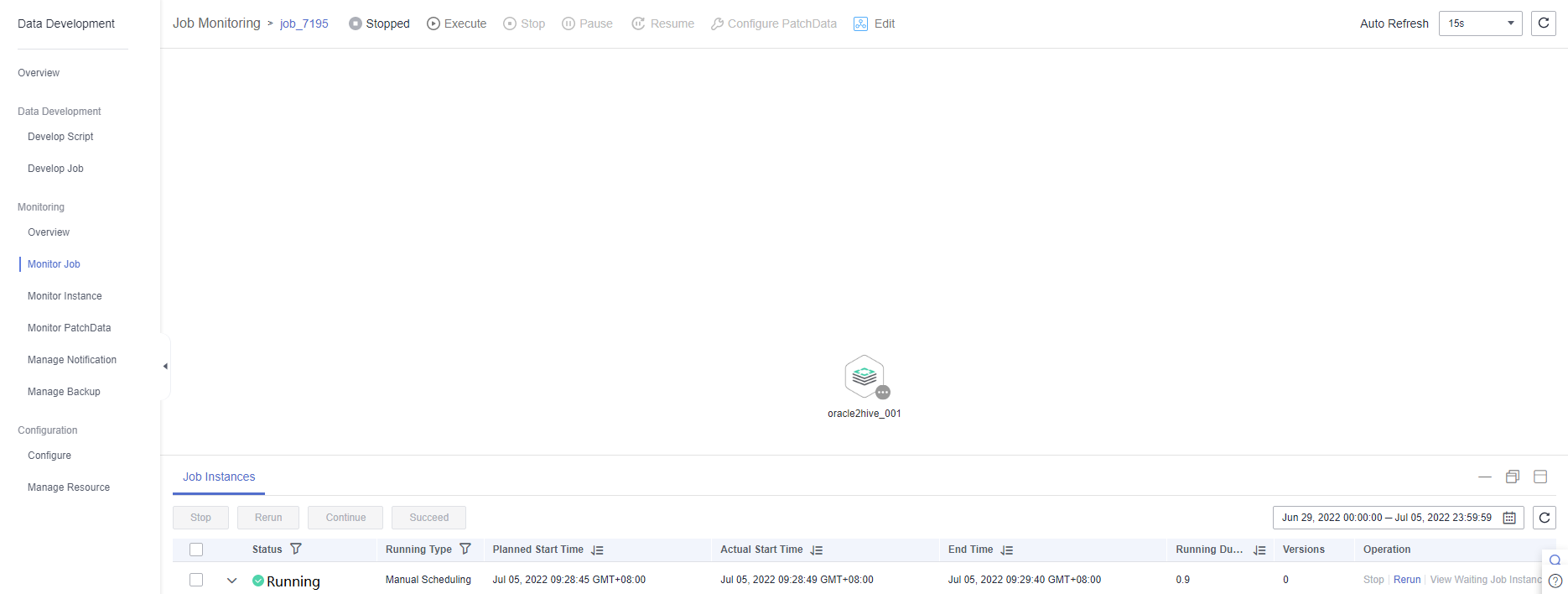

  8. After the data development job is executed, click Monitor in the upper right corner to go to the Monitor Job page and check whether the generated task or instance meets requirements.
    Figure 7 Viewing the execution result
