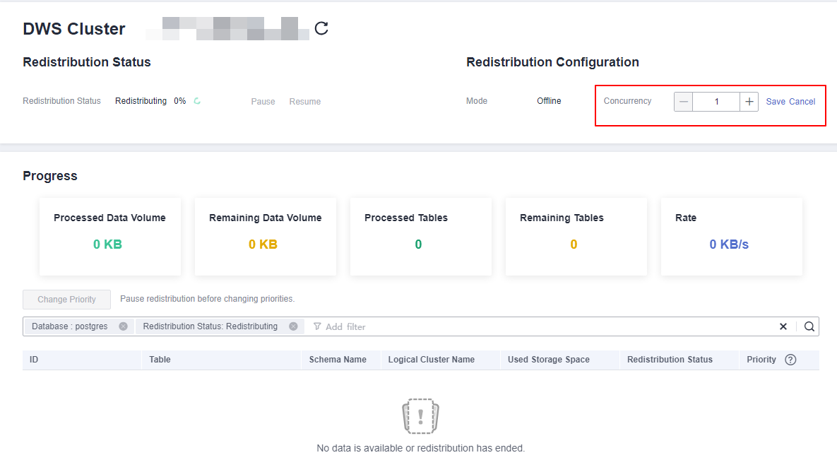

  4. On the View Redistribution Details page, you can view monitoring information, such as the redistribution mode, redistribution progress, and data table redistribution details of the current cluster. You can also pause and resume redistribution. When redistribution is paused, you can set the redistribution priority and change the number of concurrent redistribution tasks.

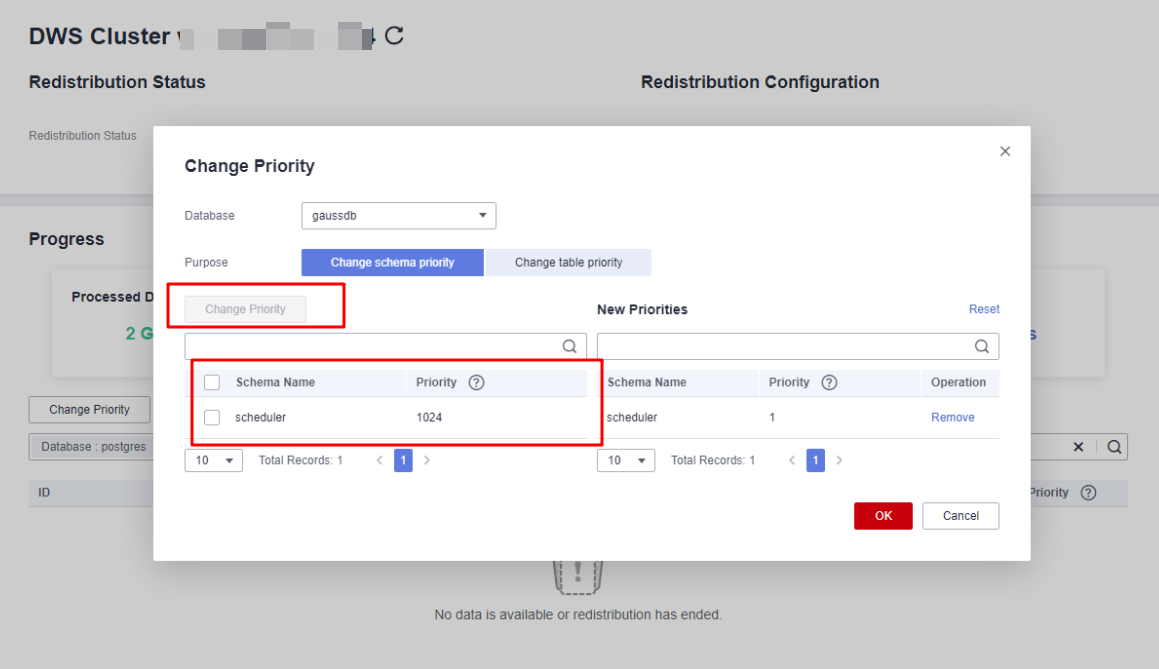

  5. When redistribution is paused, you can set the redistribution priority (in schema or table dimension), and redistribution will be performed based on the configured redistribution sequence. You can also set the redistribution priority before the redistribution starts.
    Figure 1 Redistribution priority
  6. During redistribution, you can click Modify to adjust the redistribution concurrency. Clusters running version 8.1.0 or earlier do not support dynamic adjustment. To change the redistribution concurrency, pause the redistribution first.

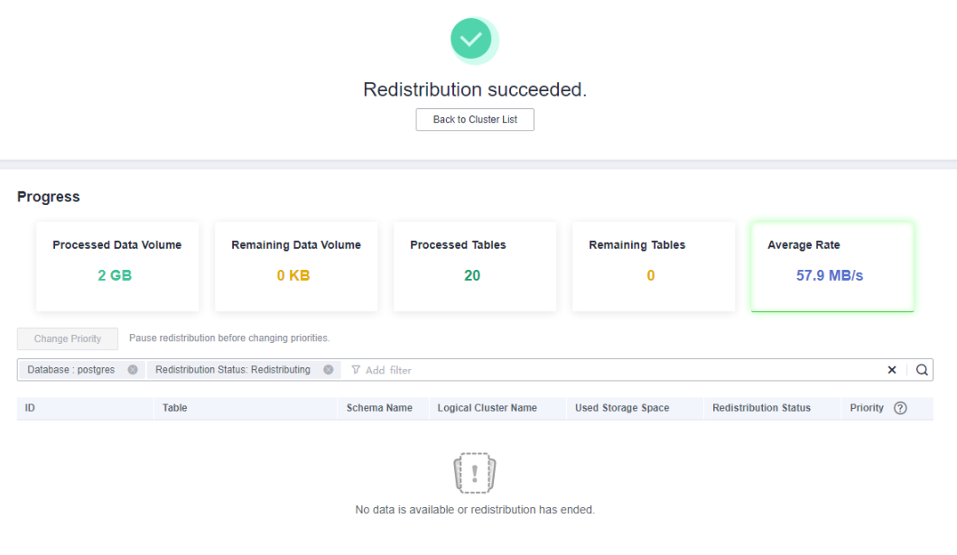

  7. After the redistribution is complete, check the redistribution progress statistics, including the amount of completed data, amount of remaining data, number of completed tables, number of remaining tables, and redistribution rate.
