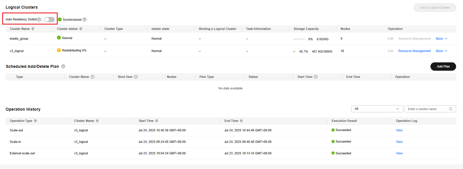

- In the navigation pane, choose Logical Clusters to access the page for cluster management. Because once you have created a Storage-compute decoupled cluster, it will be in logical cluster mode.
- Enable Auto Resiliency Switch.
Once enabled, the system provisions idle nodes (which are free of charge) and monitors workload. It then automatically creates and deletes read-only elastic clusters during peak and off-peak hours, respectively.
Figure 1 Enabling auto scaling for logical clusters

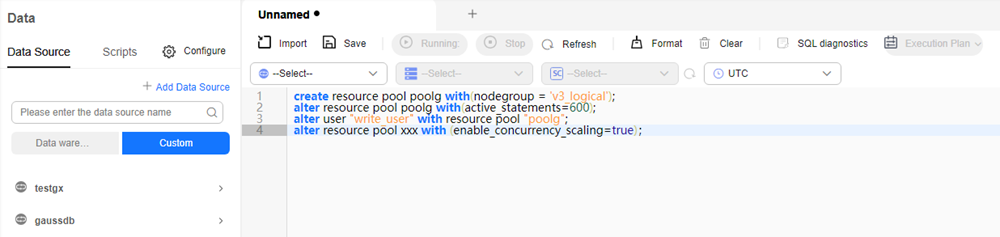

- After auto resiliency is enabled, run SQL statements after completing the operation described in Using the SQL Editor to Connect to a Cluster to create and set a resource pool, and bind a user to the resource pool, and enable auto scaling for the specified resource pool. In the command, poolg indicates the resource pool name, which can be customized.
1 2 3
create resource pool "poolg" with(nodegroup = 'v3_logical'); alter user "write_user" with resource pool "poolg"; alter resource pool "poolg" with (enable_concurrency_scaling=true);
