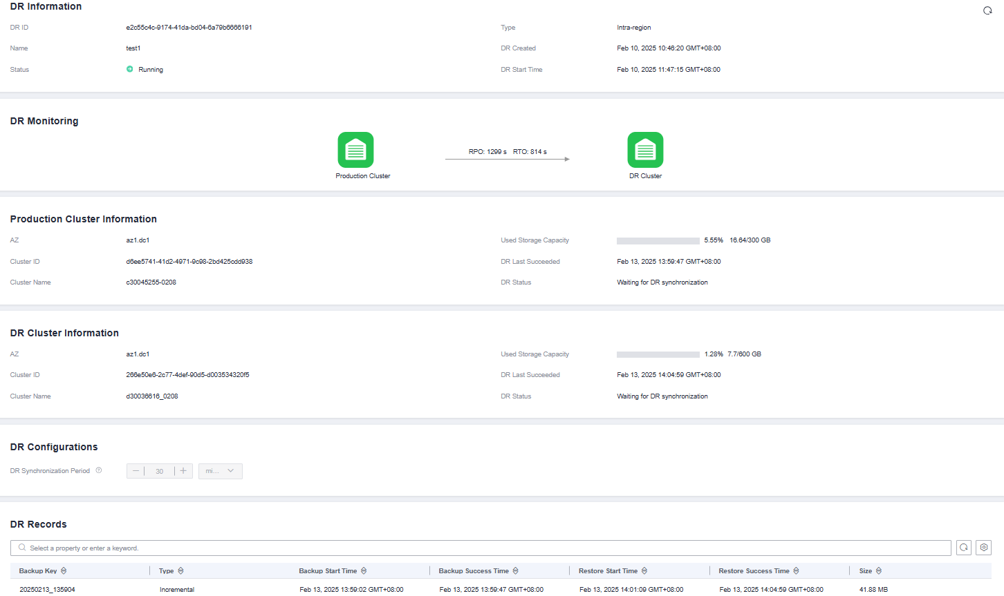

Viewing DR Information
  1. Log in to the DWS console.
  2. In the navigation pane on the left, choose Cluster > Management > DR Tasks.
  3. In the DR list, click the name of a DR task.
    On the displayed page, view the following information:
    • DR Information: You can view the DR ID, DR name, DR type, DR creation time, DR start time, and DR status.
    • DR Monitoring: You can view real-time DR recovery point objective (RPO) and recovery time objective (RTO) data.
      • Recovery point objective (RPO) indicates the maximum amount of data loss that the system can tolerate.
      • Recovery time objective (RTO) indicates the maximum allowable downtime for the system.
    • Production Cluster Information: You can view the production cluster ID, cluster name, AZ, used storage capacity, cluster DR status, and the time of the latest successful DR task.
    • DR Cluster Information: You can view the DR cluster ID, cluster name, AZ, used storage capacity, cluster DR status, and the time of the latest successful DR task.
    • DR Configurations: You can view and modify the DR synchronization period.
    • DR Records: You can view the historical records of periodic DR synchronization, including the time and data volume of full synchronization, as well as the time and data volume of incremental synchronization, and other related data.
      Figure 1 DR details
