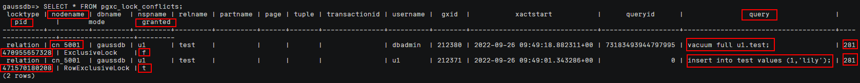

- Connect to the cluster and run the SQL statement to query the current lock conflict statement.
select * from pgxc_lock_conflicts;
- Decide whether to terminate the lock based on the statement content. To terminate the lock, run the following statement. pid and nodename are obtained from the previous step.
execute direct on (nodename) 'SELECT PG_TERMINATE_BACKEND(pid)';
