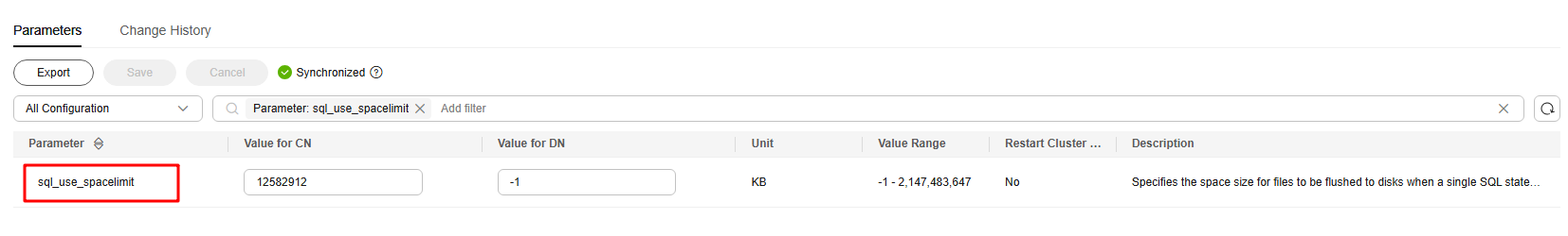

- Adjust the database parameters for controlling the disk space of service statements. For details about the parameters, see Statement Disk Space Control. For details about the procedure, see Modifying Database Parameters.
For example, the default value of sql_use_spacelimit is 10% of the total storage space of the DB instance. If the storage space is sufficient, you can increase the value. If the disk write volume of a single DN exceeds the value, DWS stops the query and displays a message indicating that the disk write volume of a single DN exceeds the threshold.
