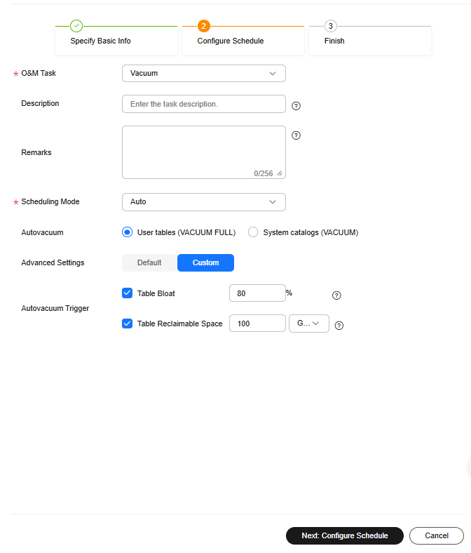

  3. After the read-only state is canceled, run the Vacuum command to delete unnecessary data. Click the cluster name.
  4. In the navigation pane, choose Intelligent O&M.
  5. Click the O&M Plan tab. Click Add O&M Task. For details, see Adding an O&M Plan.
  6. Perform the following operations on the Add O&M Task page:
    • Select Vacuum for O&M Task.
    • Set Scheduling Mode to Auto. DWS automatically scans tables that require VACUUM operation.
    • Select System catalogs or User tables for Autovacuum.
      • If there are a large number of UPDATE and DELETE operations, select the User tables.
      • If there are a large number of CREATE and DELETE operations, select System catalogs.
  7. Click Next: Configure Schedule to configure the schedule and Vacuum type. You are advised to select Periodic for Task Type. DWS automatically executes VACUUM in your selected time windows.
    For automatic Vacuum O&M tasks, the system uses the VACUUM FULL operation to process user tables. VACUUM FULL holds a level 8 lock, which blocks other transactions. Other transactions will be in lock waiting during VACUUM FULL execution. After 20 minutes, a timeout error is reported. Therefore, do not perform other transactions in the configured time window.
  8. After confirming that the information is correct, click Next to complete the configuration.
