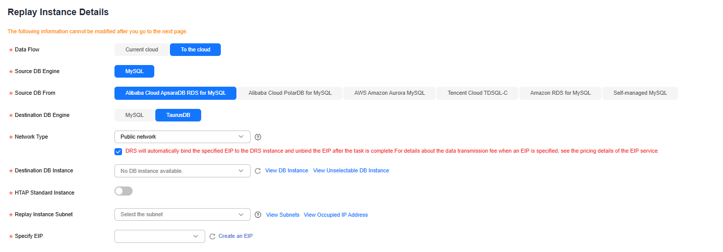

- Replay instance information Figure 1 Replay instance information
Table 4 Replay instance settings Parameter
Description
Data Flow
Select To the cloud.
- Current cloud refers to the workload replay scenario where both source and destination databases are Huawei Cloud DB instances.
- To the cloud refers to the workload replay scenario where the destination database is a Huawei Cloud DB instance and data needs to be transferred.
Source DB Engine
Select MySQL.
Source DB From
Platform where the source database is from. The audit log format varies depending on the source database. For details, see Audit Log Format.
Destination DB Engine
Select TaurusDB.
Network Type
Public network is used as an example.
Available options: Public network, VPC, VPN or Direct Connect
Destination DB Instance
The TaurusDB DB instance you created. Ensure that baseline data has been developed in the destination database.
Replay Instance Subnet
Select the subnet where the replay instance is located. You can also click View Subnets to go to the network console to view the subnet where the instance resides.
By default, the DRS instance and the destination DB instance are in the same subnet. You need to select the subnet where the DRS instance resides, and there are available IP addresses for the subnet. To ensure that the replay instance can be successfully created, only subnets with DHCP enabled are displayed.
Specify EIP
This parameter is available when you select Public network for Network Type. Select an EIP to be bound to the DRS instance. DRS will automatically bind the specified EIP to the DRS instance and unbind the EIP after the task is complete.

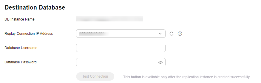

- Destination database information Figure 4 Destination database information
Table 8 Destination database settings Parameter
Description
DB Instance Name
The TaurusDB instance you selected when creating the task. This parameter cannot be changed.
Replay Connection IP Address
The primary node IP address of a DB instance is selected by default, but if the instance has a proxy IP address, you can also select that address if needed.
Database Username
The username for accessing the destination database.
Database Password
The password for the database username.
The username and password of the destination database are encrypted and temporarily stored on the DRS instance host during the workload replay. After the task is deleted, the username and password are permanently deleted.
