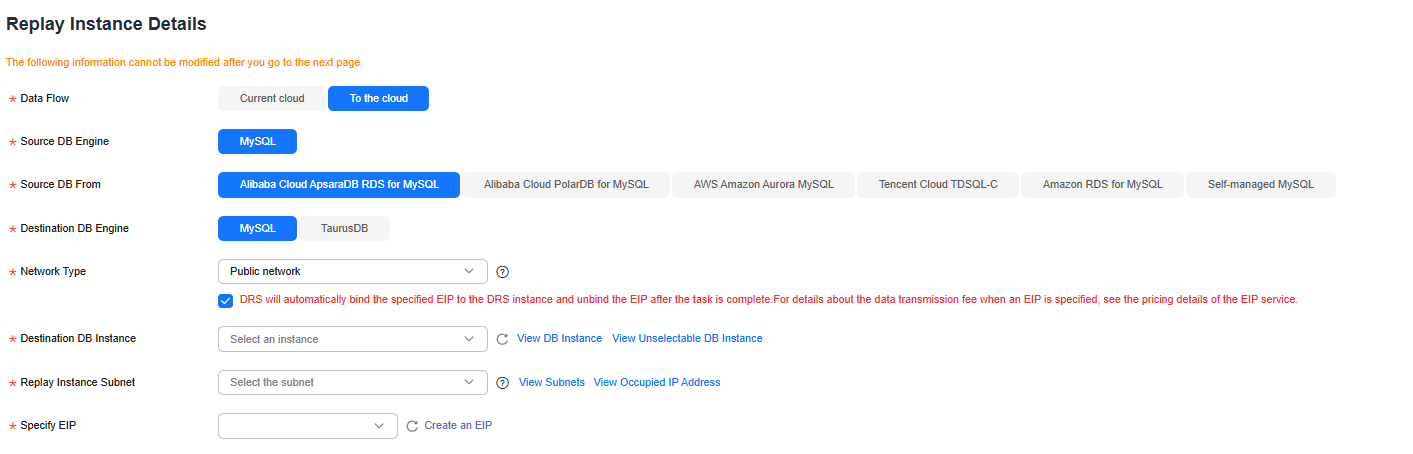

- Replay instance information Figure 1 Replay instance information
Table 4 Replay instance settings Parameter
Description
Data Flow
Select To the cloud.
- Current cloud refers to the workload replay scenario where both source and destination databases are Huawei cloud DB instances.
- To the cloud refers to the workload replay scenario where the destination database is a Huawei cloud DB instance and data needs to be transferred to the cloud.
Source DB Engine
Select MySQL.
Source DB From
Platform where the source database is from. The audit log format varies depending on the source database. For details, see Audit Log Format.
Destination DB Engine
Select MySQL.
Network Type
Public network is used as an example.
Available options: Public network, VPC, VPN or Direct Connect
Destination DB Instance
The RDS for MySQL DB instance you created. Ensure that baseline data has been developed in the destination database.
Replay Instance Subnet
Select the subnet where the replay instance is located. You can also click View Subnets to go to the network console to view the subnet where the instance resides.
By default, the DRS instance and the destination DB instance are in the same subnet. You need to select the subnet where the DRS instance resides, and there are available IP addresses for the subnet. To ensure that the replay instance can be successfully created, only subnets with DHCP enabled are displayed.
Specify EIP
This parameter is available when you select Public network for Network Type. Select an EIP to be bound to the DRS instance. DRS will automatically bind the specified EIP to the DRS instance and unbind the EIP after the task is complete.

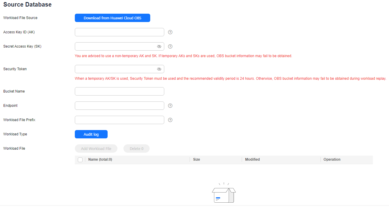

- Source database information Figure 3 Source database information
Table 7 Source database settings Parameter
Description
Workload File Source
Specifies where the workload file in the source database is from.
Access Key ID (AK)
Access key ID, which is a unique identifier used in conjunction with a secret access key to sign requests cryptographically.
Secret Access Key (SK)
Used together with the access key ID to sign requests cryptographically. It identifies a request sender and prevents the request from being modified.
- Based on the principle of least permission, the AK/SK permissions must be minimized. If both temporary and permanent AKs/SKs are available, you are advised to use a temporary AK/SK. Permanent AKs/SKs are used only in scenarios where temporary AKs/SKs cannot meet requirements. For example, if a large number of logs need to be downloaded for a long time, temporary AKs/SKs may become invalid due to timeout.
- AK/SK information of the user is encrypted and temporarily stored in the system until the task is deleted.
Security Token
When a temporary AK/SK is used, Security Token must be used, and the recommended validity period is 24 hours. Otherwise, OBS bucket information may fail to be obtained during workload replay.
Bucket Name
Name of the OBS bucket for storing workload files.
Endpoint
OBS provides an endpoint for each region. An endpoint can be considered as the domain name of OBS in a region, and is used to process access requests from the region.
Workload File Prefix
Prefix of a file name in the OBS bucket. Only files whose names start with this prefix will be displayed.
Workload Type
Only Audit log is supported.
Workload File
Select the required workload file.

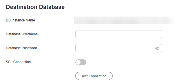

- Destination database information Figure 4 Destination database information
Table 8 Destination database settings Parameter
Description
DB Instance Name
The RDS DB instance you selected when creating the task. This parameter cannot be changed.
Database Username
The username for accessing the destination database.
Database Password
The password for the database username.
SSL Connection
If SSL connection is required, enable SSL on the destination database, ensure that related parameters have been correctly configured, and upload an SSL certificate.
NOTE:- The maximum size of a single certificate file that can be uploaded is 500 KB.
- If SSL is disabled, your data may be at risk.
The username and password of the destination database are encrypted and temporarily stored on the DRS instance host during the workload replay. After the task is deleted, the username and password are permanently deleted.

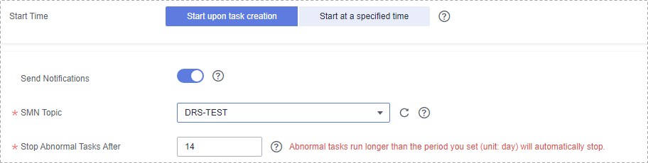

- On the displayed page, specify Start Time, Send Notification, SMN Topic, and Stop Abnormal Tasks After and confirm that the configured information is correct and click Submit to submit the task. Figure 6 Task startup settings
Table 10 Task startup settings Parameter
Description
Start Time
Set Start Time to Start upon task creation or Start at a specified time based on site requirements.
NOTE:After a replay task is started, the performance of the source and destination databases may be affected. You are advised to start a replay task during off-peak hours.
Send Notifications
SMN topic. This parameter is optional. If an exception occurs during workload replay, the system will send a notification to the specified recipients.
SMN Topic
This parameter is available only after you enable Send Notifications and create a topic on the SMN console and add a subscriber.
For details, see Simple Message Notification User Guide.
Number of days after which an abnormal task automatically stops. The value must range from 14 to 100. The default value is 14.
NOTE:Tasks in the abnormal state are still charged. If tasks remain in the abnormal state for a long time, they cannot be resumed. Abnormal tasks running longer than the period you set (unit: day) will automatically stop to avoid unnecessary fees.
