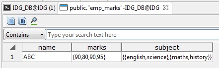

  2. Configure Array Dimensions. It specifies the array dimensions for the column.
    Example: If array dimension for a column is defined as integer [], then it will add the column data as single dimension array.
    The marks column in the above table was created as single dimension and subject column as two dimensions.

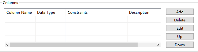

  7. To add comments to Column in the Create Regular Table dialog box, add column information in Description of Column (Max 5000 chars) text box and click Add. You can also add comments in the column addition dialog box. You can check comments in general table properties.
  8. After you enter all information for new column, click Add. You can also delete a column from a list or change the order of columns. After defining all columns, click Next.
  9. You can add, delete, and edit columns, and adjust the sequence of columns.
