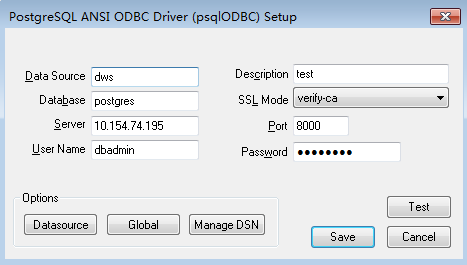

  4. Configure a data source to be connected to.
    1. On the User DSN tab, click Add and choose PostgreSQL Unicode for setup.
      Figure 1 Configuring a data source to be connected to
      You can view the values of Server and Port on the DWS console. Log in to the DWS console and choose Clusters > Management > Client Connections from the navigation pane on the left. In the Data Warehouse Connection Information area, select a cluster and obtain its Private Network IP Address or Public Network IP Address. For details, see Obtaining the Connection Address of a DWS Cluster.
    2. Click Test to verify that the connection is correct. If Connection successful is displayed, the connection is correct.
