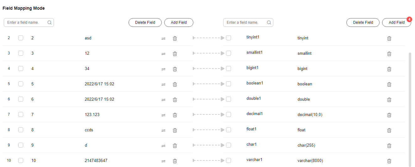

- Configuring field mapping.
After configuring source and destination parameters, you need to configure the mapping between source and destination columns. After the field mapping is configured, the job writes source fields to fields of the corresponding types at the destination based on the field mapping.
- Field mapping configuration: Set the field mapping mode and batch field mapping rule.
- Field Mapping Mode
- Same name: Fields with the same name are mapped. Fields with the same column name are automatically mapped.
- Same row: Fields with different names but in the same row of the source and destination table are mapped. Source and destination fields in the same row are automatically mapped.
- Batch Field Mapping: This parameter is not displayed when Use SQL Statement in the source configuration is set to Yes.
Enter field mappings, with one field mapping in each row. Place fields from the source table to the left of the equal sign (=) and fields from the destination table to the right of the equal sign (=), for example, reader_column=writer_column.
Click View and Edit to set the batch field mapping.
- Field mapping: batch conversion, field adding, and row moving

- During the migration, the field types at the source and destination may not match. As a result, dirty data is generated, and data cannot be written to the destination. For details about the number of dirty data records allowed during the migration, see the next step.
- If a field at the source is not mapped to a field at the destination, the field at the source will not be synchronized to the destination.
- In other scenarios, CDM automatically maps fields of the source table and the destination table. You need to check whether the mapping and time format are correct. For example, check whether the source field type can be converted into the destination field type.
- If the field mapping is incorrect, you can drag fields to adjust the mapping. (This function is supported when Use SQL Statement in the source configuration is set to No.)
- If you cannot obtain all columns by obtaining sample values on the field mapping page, you can click
to add a custom field or click
in the Operation column to create a field converter to ensure that all required data can be imported to the destination. - In the Field Mapping area, you can click
to add custom constants, variables, and expressions. - The column name is available only the Extract first row as columns parameter is set to Yes during the migration of a CSV file from OBS.
- When SQLServer is the destination, fields of the timestamp type cannot be written. You must change their type (for example, to datatime) so that they can be written.
- If the data is imported to DWS, you need to select the distribution columns in the destination fields. You are advised to select the distribution columns according to the following principles:
- Use the primary key as the distribution column.
- If multiple data segments are combined as primary keys, specify all primary keys as the distribution column.
- In the scenario where no primary key is available, if no distribution column is selected, DWS uses the first column as the distribution column by default. As a result, data skew risks exist.
