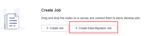

  4. Create a migration job using either of the following methods:
    Method 1: On the Develop Job page, click Create Data Migration Job.
    Figure 1 Creating a migration job (method 1)

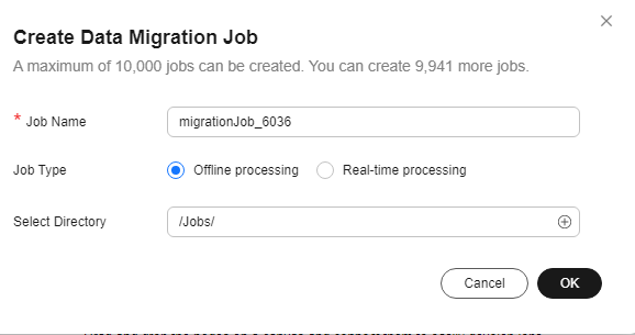

  5. In the displayed Create Data Migration Job dialog box, configure job parameters. Table 1 describes the job parameters.
    Figure 3 Configuring data migration job parameters
    Table 1 Job parameters
    Parameter
    Description
    Job Name
    Name of the job. The name must contain 1 to 128 characters, including only letters, numbers, hyphens (-), underscores (_), and periods (.).
    Job Type
    Job type. Select Offline processing.
    • Offline processing: A large amount of collected data is processed and analyzed in batches. These tasks usually use optimized computing and storage resources to ensure efficient data processing and analysis. These tasks are usually executed periodically (for example, every day or every week) to process a large amount of historical data for batch analysis and data warehouses.
    • Real-time processing: New data generated continuously is processed and analyzed in real time to meet the requirements for data timeliness. This mode requires instant processing of data upon generation and returns the result or triggers operations.
    Select Directory
    Directory to which the job belongs. The root directory is selected by default.
  6. Click OK.
