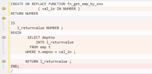

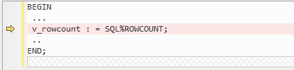

Variable Assignment
Figure 1 Input - PL/SQL
Figure 2 Output - PL/SQL

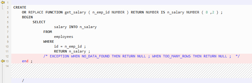

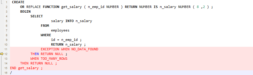

EXCEPTION Handling
GaussDB(DWS) does not support EXCEPTION handling. To migrate scripts, set the exceptionHandler parameter to True.
For DSC, this parameter must be set to the default value False.
Figure 3 Input - EXCEPTION Handling
Figure 4 Output - EXCEPTION Handling

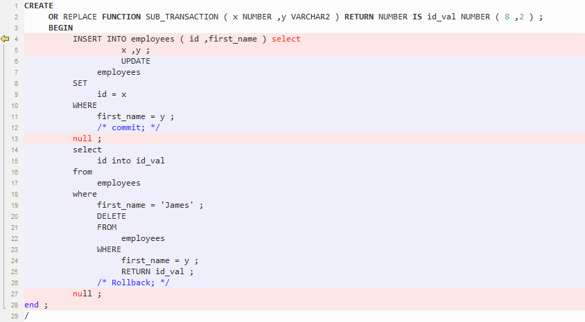

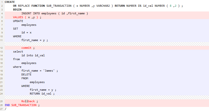

Subtransaction Handling
Subtransaction (that is commit and rollback statements in PL/SQL) is not supported. This parameter must be set to the default True.
Figure 5 Input - Subtransaction Handling
Figure 6 Output - Subtransaction Handling

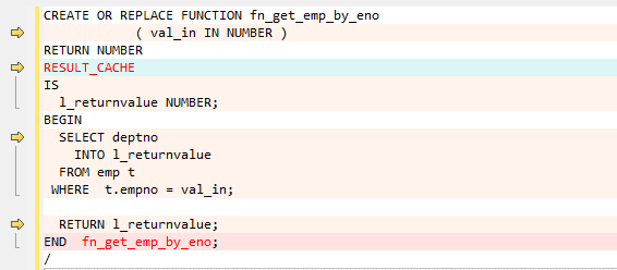

RESULT_CACHE
When a function with result cache is called, Oracle executes the function, adds the result to the result cache, and then returns the function.
When the function call is repeated, Oracle fetches the results from the cache rather than re-executing the function.
Under certain scenarios, this caching behavior can result in significant performance gains.
The target database does not support this keyword, which will be removed from the target file.
Figure 9 Input - RESULT_CACHE
Figure 10 Output - RESULT_CACHE

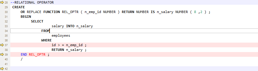

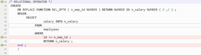

Relational Operators with Spaces
The relational operators (<=, >=, !=) with spaces are not supported by GaussDB(DWS). DSC removes spaces between the operators.
Figure 11 Input - Relational operator
Figure 12 Output - Relational operator
