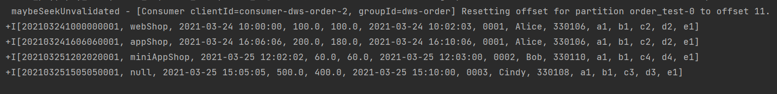

Examples
Read data from a Kafka source table, use a GaussDB(DWS) table as the dimension table. Write wide table information generated by the source and dimension tables to the print result table. The procedure is as follows:
- Connect to the GaussDB(DWS) database instance and create a table in GaussDB(DWS) as a dimension table. The table name is area_info. The SQL statement is as follows:
1 2 3 4 5 6 7 8 9
create table public.area_info( area_id VARCHAR, area_province_name VARCHAR, area_city_name VARCHAR, area_county_name VARCHAR, area_street_name VARCHAR, region_name VARCHAR, PRIMARY KEY(area_id) );
- Connect to the GaussDB(DWS) database and run the following statement to insert test data into the dimension table area_info:
1 2 3 4 5 6 7
insert into area_info (area_id, area_province_name, area_city_name, area_county_name, area_street_name, region_name) values ('330102', 'a1', 'b1', 'c1', 'd1', 'e1'), ('330106', 'a1', 'b1', 'c2', 'd2', 'e1'), ('330108', 'a1', 'b1', 'c3', 'd3', 'e1'), ('330110', 'a1', 'b1', 'c4', 'd4', 'e1');
- Run the flink sql command to create the source table, result table, and dimension table and run the following SQL statements:
CREATE TABLE orders ( order_id string, order_channel string, order_time string, pay_amount double, real_pay double, pay_time string, user_id string, user_name string, area_id string, proctime as Proctime() ) WITH ( 'connector' = 'kafka', 'topic' = 'order_test', 'properties.bootstrap.servers' = 'KafkaAddress1:KafkaPort,KafkaAddress2:KafkaPort', 'properties.group.id' = 'dws-order', 'scan.startup.mode' = 'latest-offset', 'format' = 'json' ); --Create the address dimension table. create table area_info ( area_id string, area_province_name string, area_city_name string, area_county_name string, area_street_name string, region_name string ) WITH ( 'connector' = 'dws', 'url' = 'jdbc:gaussdb://DwsAddress:DwsPort/DwsDbName', 'tableName' = 'area_info', 'username' = 'DwsUserName', 'password' = 'DwsPassword', 'lookupCacheMaxRows' = '10000', 'lookupCacheExpireAfterAccess' = '2h' ); --Create a wide table based on the address dimension table for detailed order information. create table order_detail( order_id string, order_channel string, order_time string, pay_amount double, real_pay double, pay_time string, user_id string, user_name string, area_id string, area_province_name string, area_city_name string, area_county_name string, area_street_name string, region_name string ) with ( 'connector' = 'print' ); insert into order_detail select orders.order_id, orders.order_channel, orders.order_time, orders.pay_amount, orders.real_pay, orders.pay_time, orders.user_id, orders.user_name, area.area_id, area.area_province_name, area.area_city_name, area.area_county_name, area.area_street_name, area.region_name from orders left join area_info for system_time as of orders.proctime as area on orders.area_id = area.area_id; - Write data to Kafka.
1 2 3
{"order_id":"202103241606060001", "order_channel":"appShop", "order_time":"2021-03-24 16:06:06", "pay_amount":"200.00", "real_pay":"180.00", "pay_time":"2021-03-24 16:10:06", "user_id":"0001", "user_name":"Alice", "area_id":"330106"} {"order_id":"202103251202020001", "order_channel":"miniAppShop", "order_time":"2021-03-25 12:02:02", "pay_amount":"60.00", "real_pay":"60.00", "pay_time":"2021-03-25 12:03:00", "user_id":"0002", "user_name":"Bob", "area_id":"330110"} {"order_id":"202103251505050001", "order_channel":"qqShop", "order_time":"2021-03-25 15:05:05", "pay_amount":"500.00", "real_pay":"400.00", "pay_time":"2021-03-25 15:10:00", "user_id":"0003", "user_name":"Cindy", "area_id":"330108"}
- The following figure shows the result.
