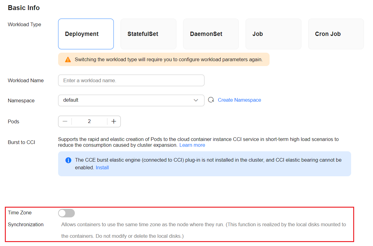

- In the Basic Info area of the Create Workload page, enable Time Zone Synchronization so that the same time zone will be used for a pod and its host node. After completing other settings, create the workload. Figure 1 Enabling the time zone synchronization

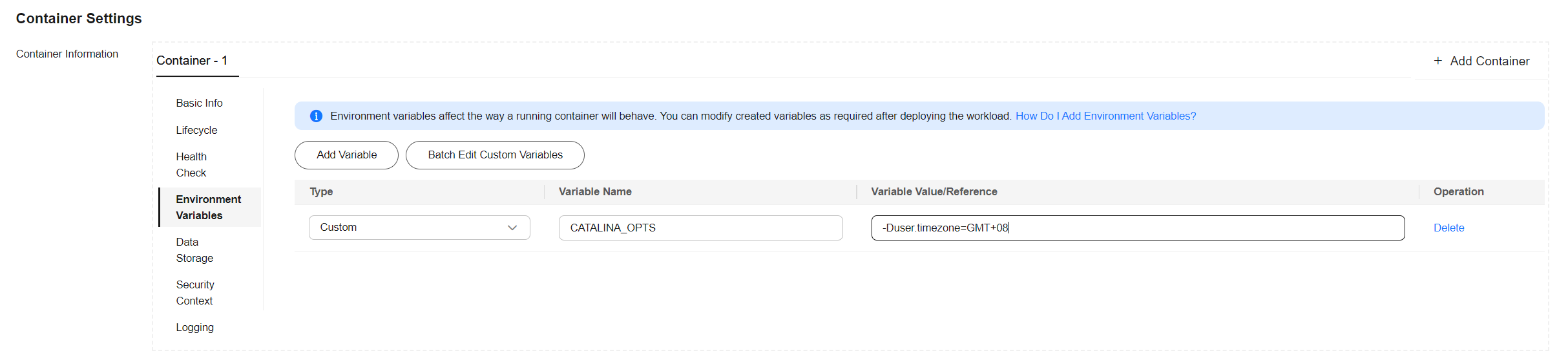

- In the Container Settings area, click Environment Variables and add the following environment variable:
- Environment variable name: CATALINA_OPTS
- Environment variable value: -Duser.timezone=GMT+08

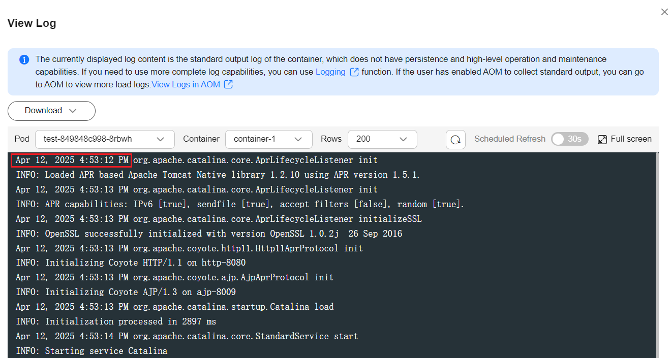

- In the workload list, locate the row containing the workload, click Log in the Operation column, and check whether the time zone in the logs is the same as that of the pod and node. For details about how to check the time zone of a node and pod, see Scenario 1: Configuring the Time Zone Synchronization Between a Pod and Its Host Node.
