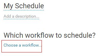

and choose Schedule to open the Coordinator editor. - On the job editing page, click My Schedule to change the job name.
- Click to select the workflow to be orchestrated.
