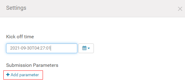

in the upper right corner of the editor, select
from the displayed menu, set the start time of the bundle task, click +Add parameter to add parameters, and close the dialog box to save the settings.
Because the time zone is changed, the difference between the time and the local time may be several hours.
