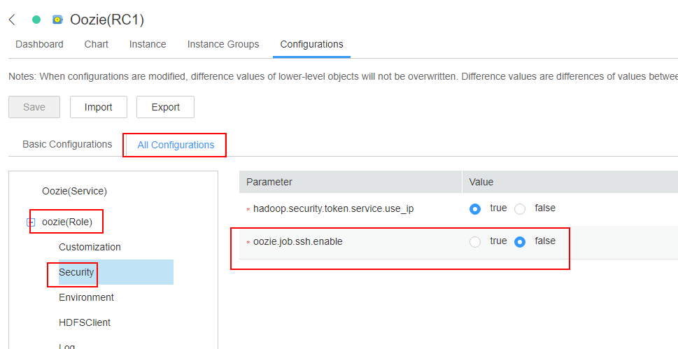

- Enable the SSH function. (Skip this step if the oozie.job.ssh.enable parameter is unavailable for the current cluster.)
- On FusionInsight Manager, choose Cluster > Services > Oozie and click the Configurations tab and then All Configurations. In the navigation pane on the left, choose oozie(Role) > Security, change the value of oozie.job.ssh.enable to true, and click Save. In the displayed dialog box, click OK to save the configuration.
- On the Dashboard page of Oozie, choose More > Restart Service in the upper-right corner to restart Oozie.
