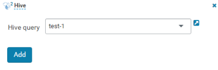

and choose Workflow to open the Workflow editor. - Click Documents, click
to select a Hive script from the operation list, and drag it to the operation page. - In the HiveServer2 Script dialog box that is displayed, select the saved Hive script. For details about how to save the Hive script, see Using Hue to Execute HiveQL. Select a script and click Add.
- Configure the Job XML, for example, to the HDFS path /user/admin/examples/apps/hive2/hive-site.xml. For details, see Submitting an Oozie Hive2 Job Using Hue.
