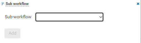

next to Sub workflow and drag it to the operation area. - In the Sub workflow dialog box that is displayed, set Sub-workflow, for example, to Java-Workflow (one of the created workflows) from the drop-down list box, and click Add.
