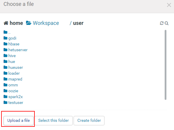

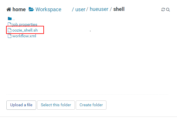

- Click FILE+ to add the Shell command execution file or Oozie example execution file. You can select a file stored in HDFS or a local file.
- If the file is stored in HDFS, select the path of the .sh file, for example, user/hueuser/shell/oozie_shell.sh.
- If you select a local file, click Upload a file on the Choose a file page to upload the local file. After the file is uploaded, select the file.
