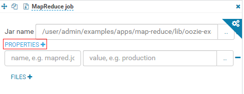

- In the displayed MapReduce job dialog box, set Jar name, for example, to /user/admin/examples/apps/map-reduce/lib/oozie-examples-5.1.0.jar. Click Add.
- Click PROPERTIES+ to add input and output properties.
For example, set the value of mapred.input.dir to /user/admin/examples/input-data/text and set the value of mapred.output.dir to /user/admin/examples/output-data/map-reduce_workflow.
