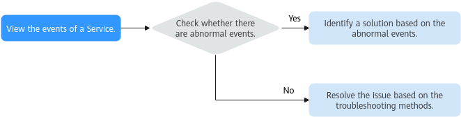

Troubleshooting Process
- Log in to the CCE console.
- Click the cluster name to access the cluster console. In the navigation pane, choose Services & Ingresses.
- Locate the row containing the target Services and click View Events in the Operation column to check whether there is any abnormal event.
- If there is, you can resolve the problem based on the events and Troubleshooting Based on the Abnormal Events.
- If there is not, the problem may be due to access issues or peripheral service configurations. You can resolve the problem by referring to Troubleshooting Based on the Common Problems.
