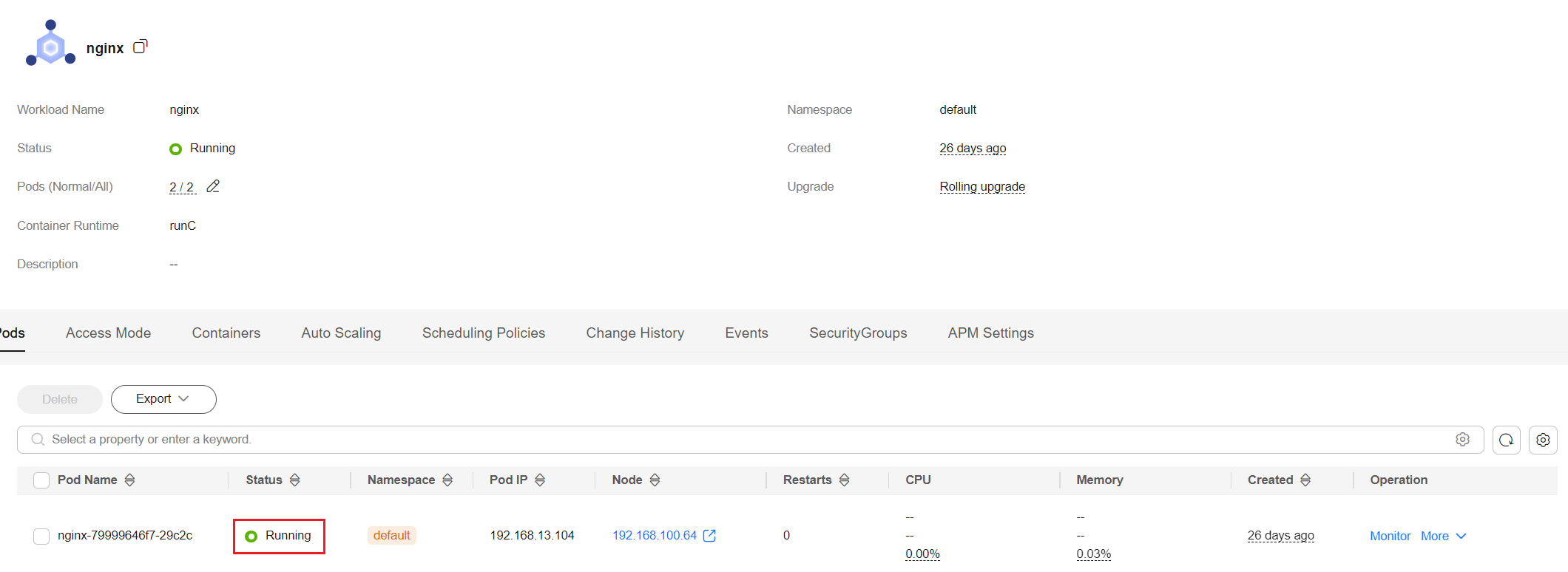

Checking the Pod Status
  1. Log in to the CCE console.
  2. Click the cluster name to access the cluster console. In the navigation pane, choose Workloads.
  3. Click the name of the target workload and check the pod statuses.

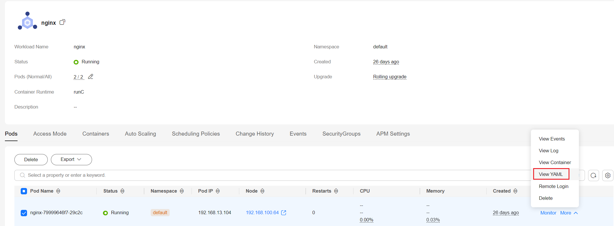

Checking Pod Configurations
  3. Click the name of the target workload. In the workload pod list, locate the row containing the target pod and choose More > View YAML in the Operation column.

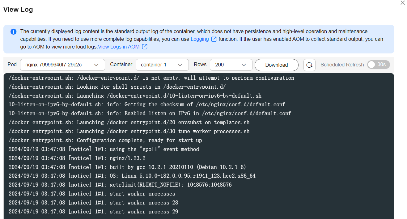

Viewing Container Logs
  3. Locate the row containing the target workload and click View Log in the Operation column.
  4. Switch between pods and containers above the logs.

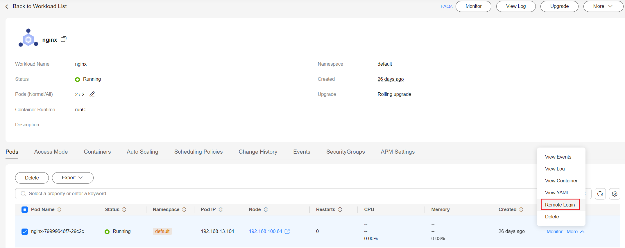

Logging In to a Container
You can log in to a container using kubectl. For details, see Logging In to a Container.
  3. Click the name of the target workload. In the workload pod list, locate the row containing the target pod and choose More > Remote Login in the Operation column.
