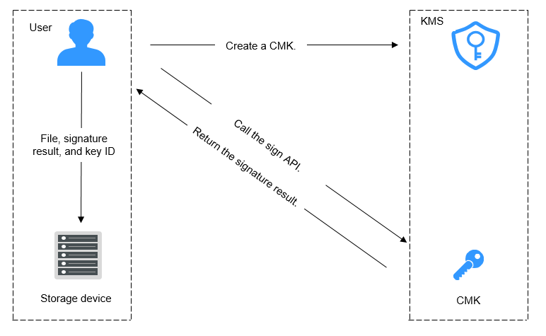

Create a CMK on KMS.
Calculate the file digest and call the sign API of KMS to sign the digest. The signature result of the digest is obtained. Transmit or store the digest signature result, key ID, and the file together. The following figure shows the signature process.
Figure 1 Signature process

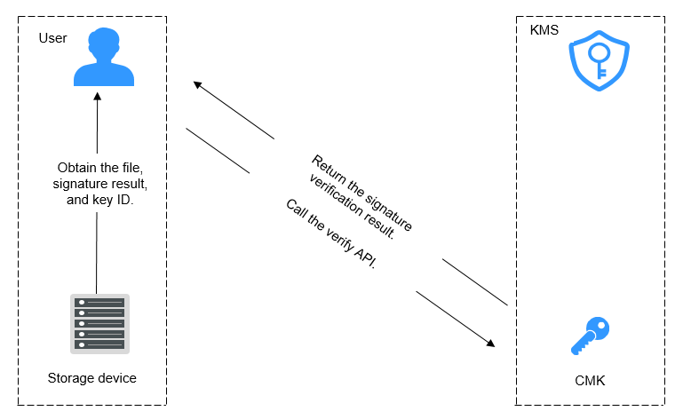

Before using a file, you need to check the integrity of the file to ensure that the file is not tampered with.
Recalculate the file digest and call the verify API of KMS with the signature value to verify the signature for the digest. The signature verification result is obtained. If the signature is verified, the file has not been tampered with. The following figure shows the signature verification process.
Figure 2 Signature verification process.
