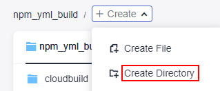

  3. Choose Create > Create Directory, as shown in Figure 2.
    Figure 2 Creating a directory

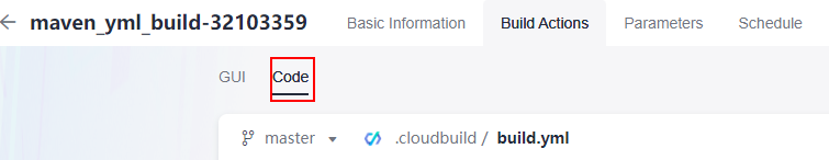

  6. Click the Code tab to view the imported build script, as shown in Figure 6.
    Figure 6 Code tab

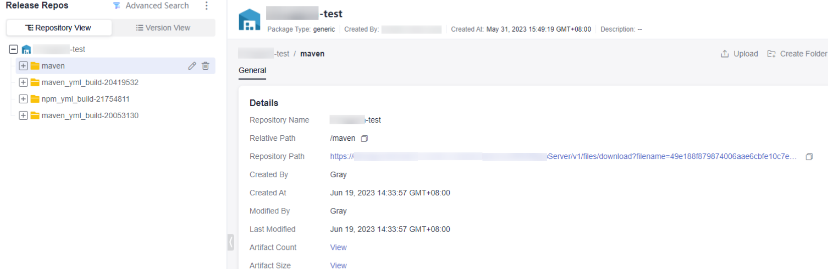

  • Verifying the uploaded the software package
    1. In the navigation pane, choose Artifact > Release Repos.
    2. Go to the release repos to view the released software package. The name of the software package is the same as the task name you use when Creating a Build Task, as shown in Figure 7.
      Figure 7 Viewing the software package
