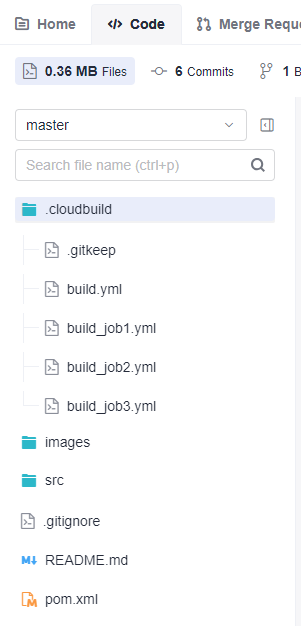

- The following figure shows the directory that stores files of the code repository.
Figure 1 Directory

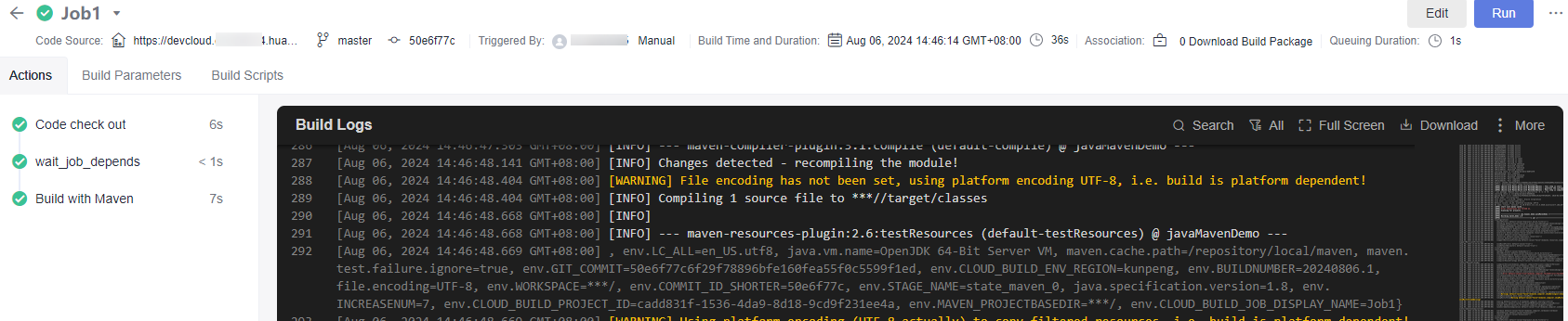

The Build Processes tab page shows the complete flowchart of the current build tasks. While the build tasks are still running, you can see that Job1 and Job2 are running in parallel, and Job3 only runs after Job1 and Job2 are finished.
- On the Build Processes tab page, click either the Job1 node in the left-hand menu or the green Job1 rectangle in the right pane. The run details page of Job1 is displayed, where you can view the build logs of Job1, as shown in Figure 2.
