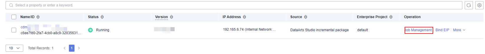

- Log in to the console, locate an instance, click Access, and click DataArts Migration.
- On the Cluster Management page, click Job Management in the Operation column.
Figure 1 Cluster Management
