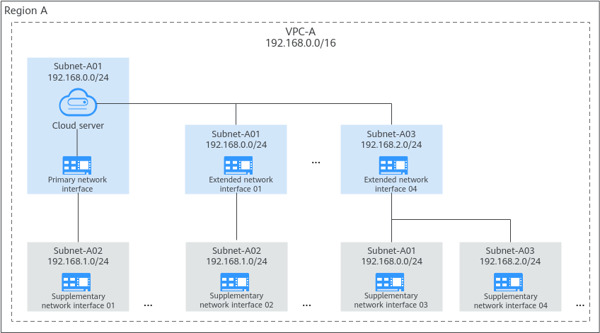

In the Cloud Native 2.0 networks, each pod is allocated a network interface or a supplementary network interface. The speed of network interface creation and binding is slower than that of pod scaling, severely affecting the container startup in large-scale batch creation. Therefore, the Cloud Native 2.0 networks provide the dynamic pre-binding of container network interfaces to accelerate pod startup while improving IP address utilization.
